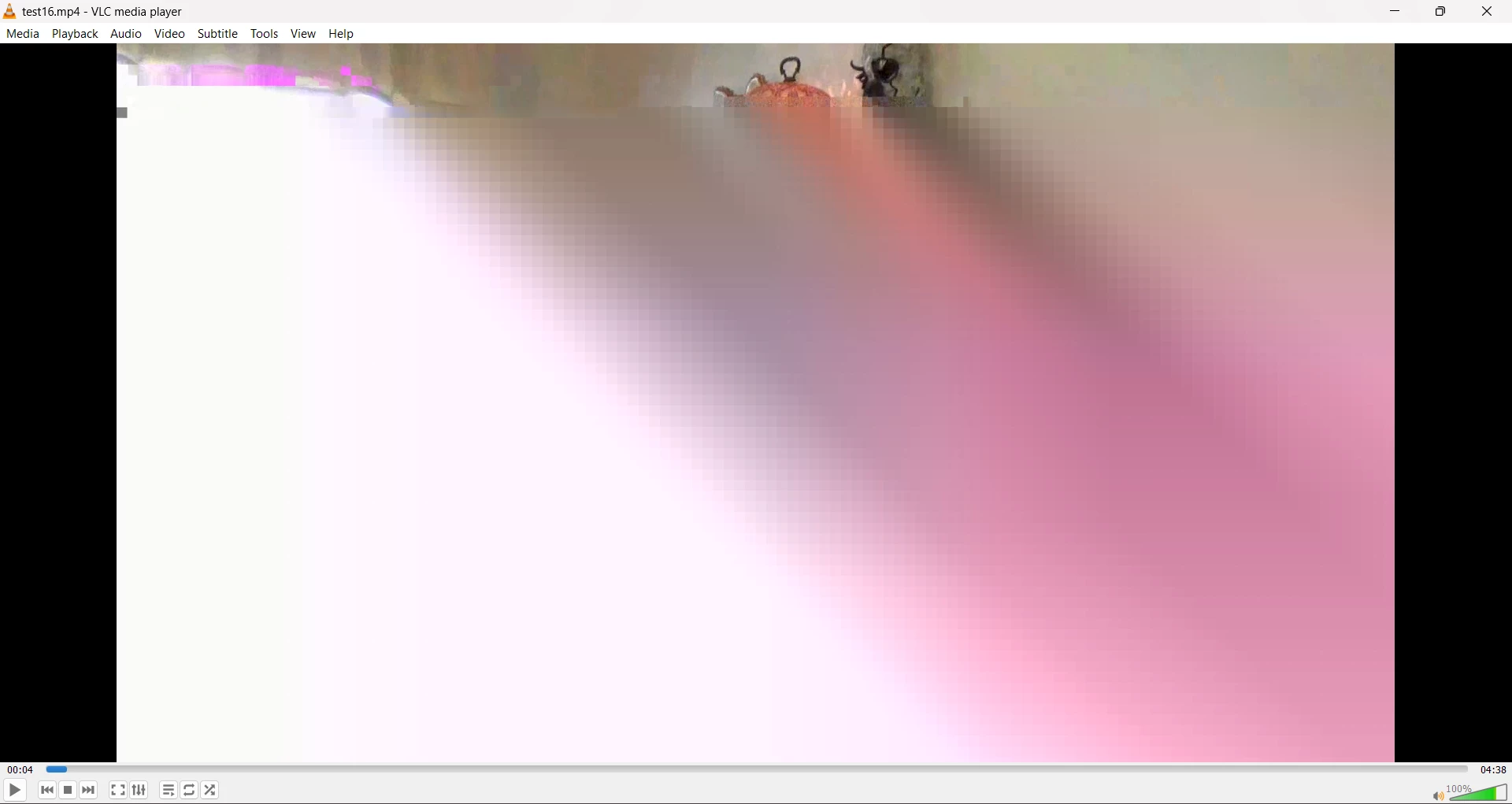

I have tried 18 times to export any of my videos. Using 3 different cameras, their formats include .MOV and .MP4. I experimented with edited footage and raw footage, recieving the exact same glitch upon exporting each video. I tried exporting directly through Adobe Premiere Pro and Media Encoder, no change in result.

UPDATE: I uninstalled my NVIDIA Graphics Driver, performed a clean installation of the latest one. It released on March 19th, 2024. The export seems to have worked! I'm going to try with my preferences next.
libdottieAuthor
March 22, 2024
UPDATE 2: I can export my videos without my preferences in the HEVC (H.265) Format, using the Renderer of Mercury Playback Engine Software Only. This process works directly from Premiere or Media Encoder.
