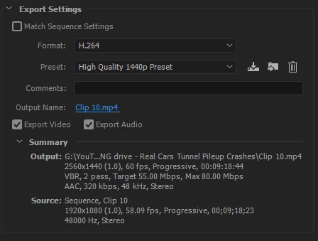

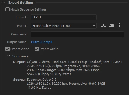

    Thank you for your response. In terms of assessing the frame rate of the exported video, I'd say it's pretty much based on my personal observations after watching that particular video. I'm not sure how to answer the second question as I'm unfamiliar with the project panel. However, I right clicked on one of the main clips included in the final video, then clicked the 'properties' option, and under that window it indicates that the clip has a frame rate of 59.57. However, another clip I include at the beginning of all my videos has a frame rate of 30.30 (not sure if it may be playing a role in this).
    Below are two images, the first one is of a project I completed just a few days ago. The second image shows the export settings of a project I worked on before this issue became apparent.

    Your clips are VFR, variable framerate. Look at the fps numbers of the clips.
    Those are done by phones and other devices trying to save on data writing to chip by only recording the number of frames they think necessary to have an acceptable viewing.
    The first one, your sequence was made from a clip PrPro saw as basically averaging 30.299 fps, and you exported at 60fps.
    The second was a sequence at 58.09 fps exported at 60fps.
    I think you need to learn how to get a basic framerate out of your device, interpret that as something normally used for fps like 30 or 60, then export to match.
