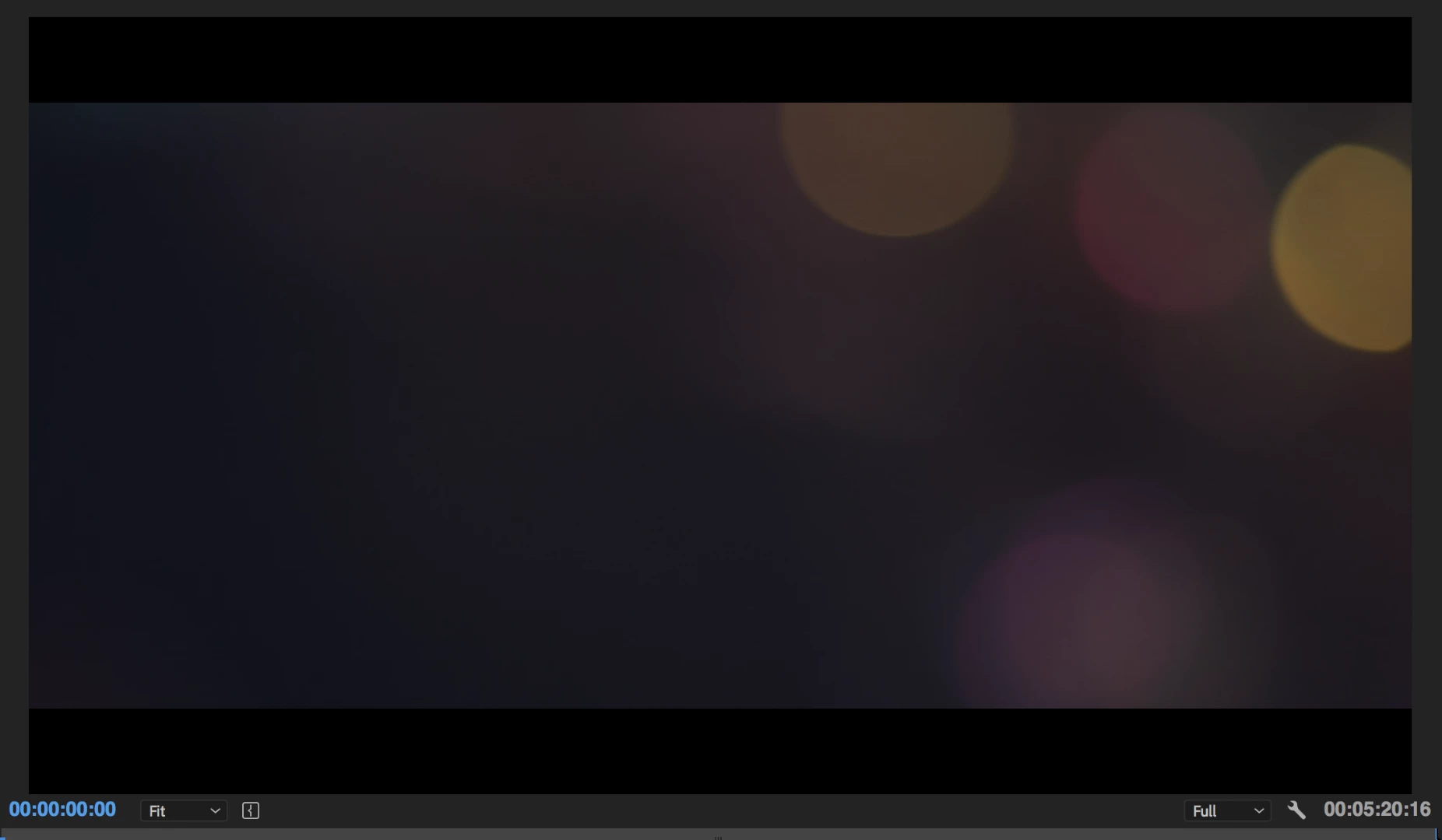

Here is a screenshot of what the video looks like in Premiere:

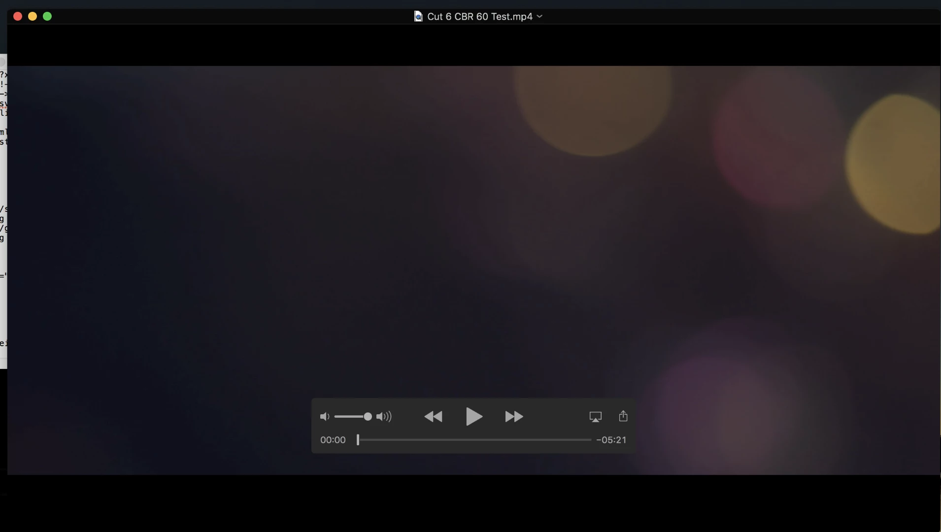

And here is one of the first frame in Quicktime player, of the exported version:
It's kind of hard to tell in these photos, but you can see defined sections in the bottom one, where it kind of looks like Quicktime is just rounding certain pixels off, and it's not just a completely smooth gradient. And it's kind of pixelated... not absolutely horrible, but nowhere near as good as in Premiere.

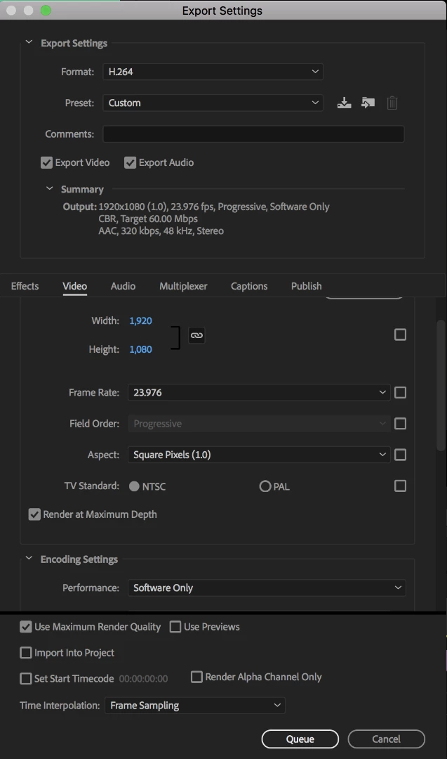

Here is what my export setting look like:

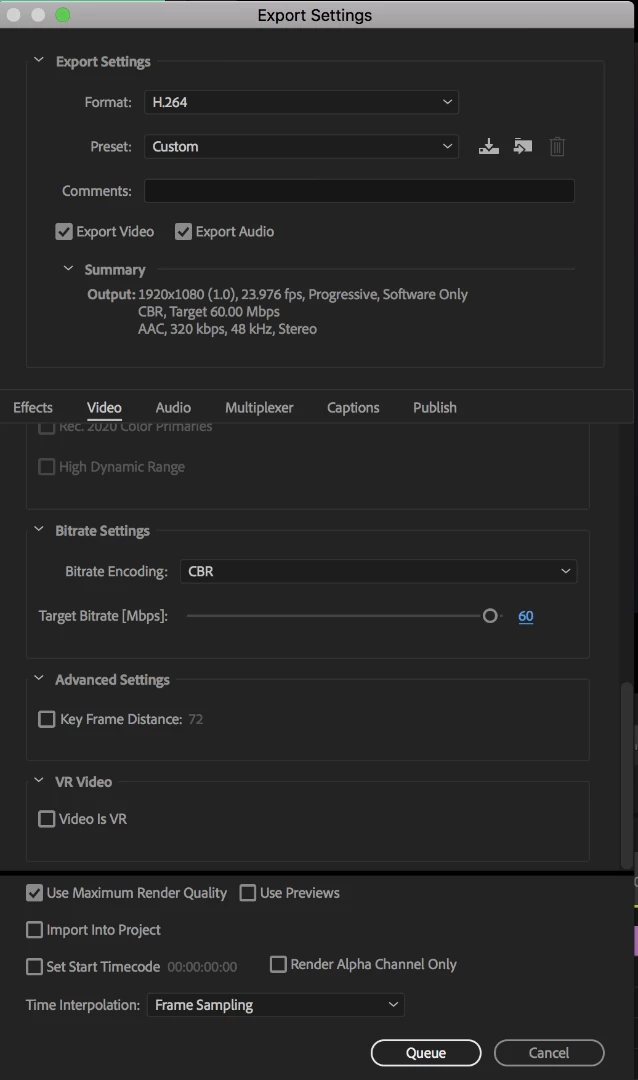

And then further down:
I've also tried exporting through Media Encoder, and that seemed to make no difference. (I have Encoder open during these screenshots, which is why there's no 'Export' button I believe, to do it within Premiere)

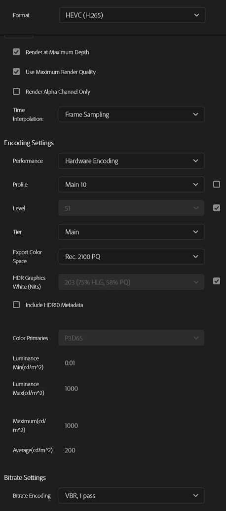

August 30, 2024
Kinda late in this topic but I have same problem as your today and somehow find a way to fix it so I write it here, maybe can help someone in future.
Here is setting that help me, target birate shouldnt be too low under 10 Mbps is fine

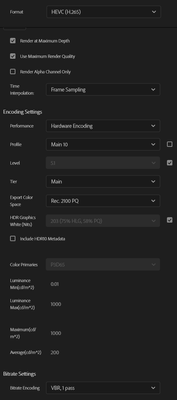

Have fun editing!
