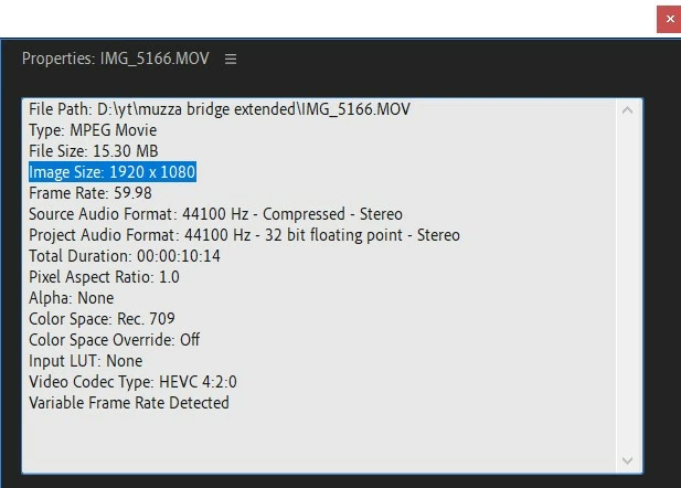

First, you need to set the Sequence Settings to what you want them to be - the specs of your source media in this case: 1920x1080, 59.94, PAR of 1.0 (Your media is Variable Framerate, which is a whole other can of worms to go into, and that's why it isn't showing a standard framerate but the average of what the fluctuating framerate of the clip is.)

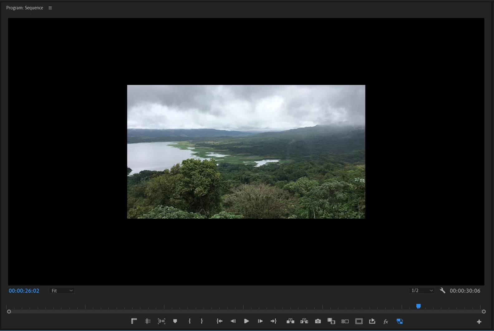

Now you will notice that your clips all have a black border around them, because they are still scaled down to fit the previously small frame size. Now you are looking at your 640x360 scaled clips in a 1920x1080 sequence.

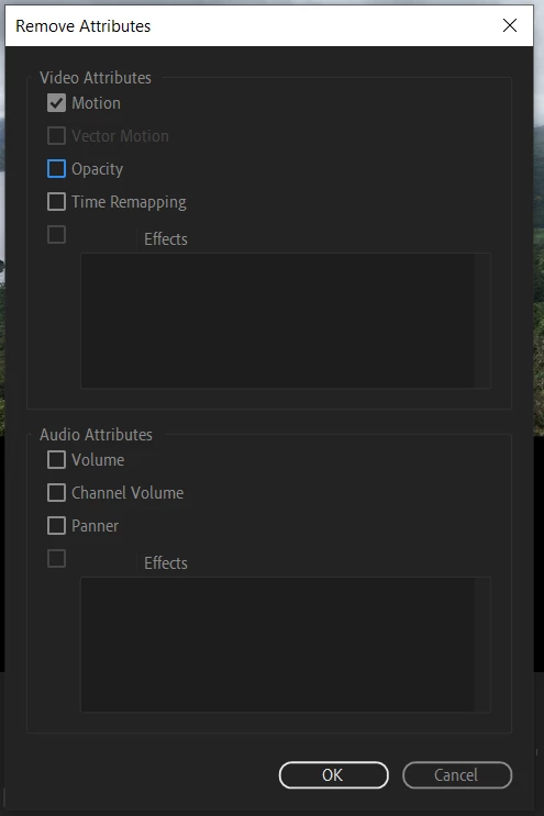

If you have No Animated Motion Properties on your clips: Then you can select all the clips, right click, choose Remove Attributes, and uncheck everything except for Motion, and click OK.
Your media that is 1920x1080 will have the scale reset to 100% and will now fit your 1920x1080 Sequence. You're done.

Working with Phone Media: If you notice issues with playback, errors, audio desync, etc., that can all be a result of the source media you're working with, which I assume is from a phone. HEVC is a really challenging video codec to work with, and Variable Framerate is like poison for editing software. With that combination you can expect a pretty rough editing experience. The media you work with has a massive impact on performance and stability.
