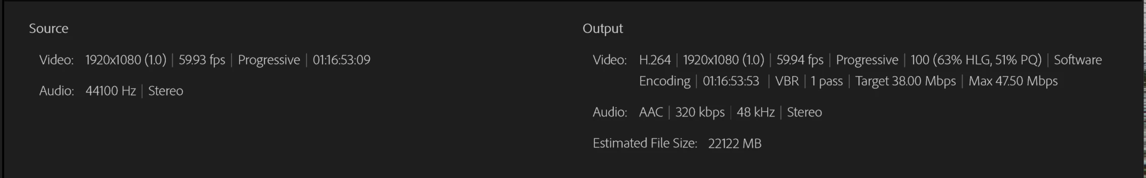

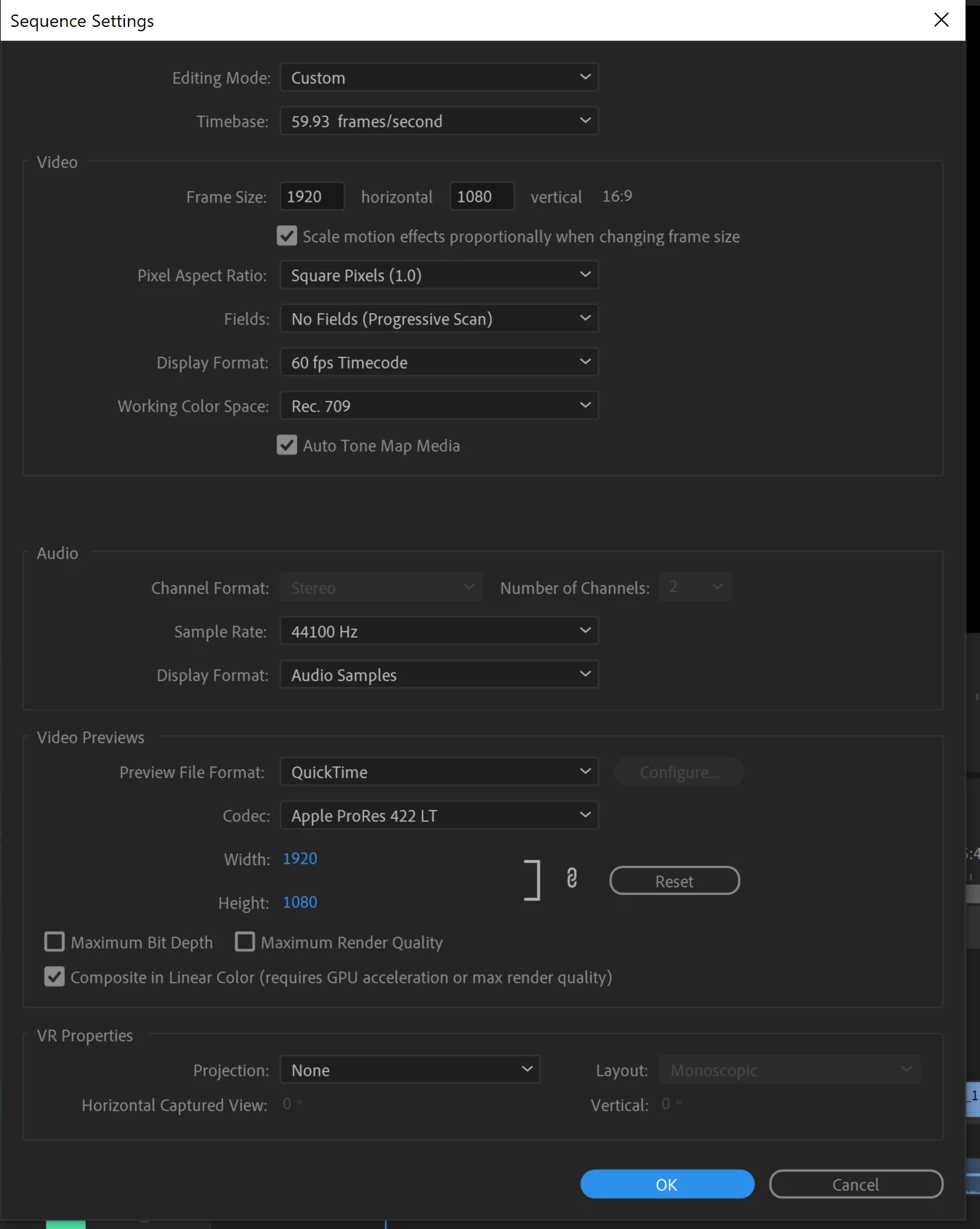

    Can you share your sequence and export settings?
    February 24, 2026
    Thank you and also thank you ​@Joëlle Bh . Does this help?  I also find that when I go back to the edit page, the video is blank. if eye click the eye and then click again the preview comes back, is this normal?  I do not seem to remember this ever happening before
