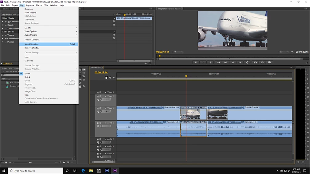

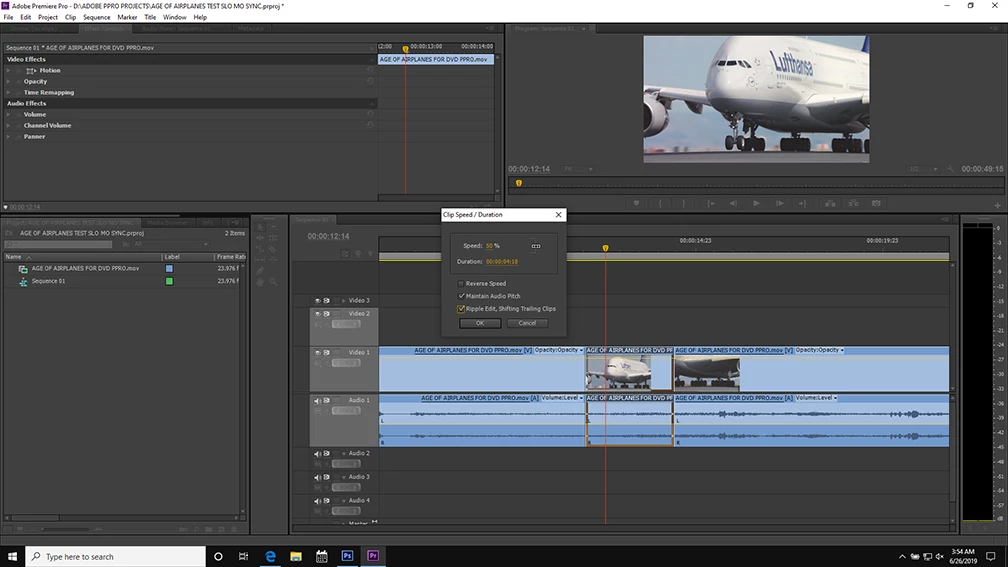

I only have old version of CS6, so your version is different... but maybe similar
In my sample, below, I have music and voice on 1 audio track already mixed...
So, I choose a point where I want to slow video.... I make a cut ( sound and video are linked ) and select the new clip (where I made the cuts ) and I go to clip / speed - duration... and I make it half speed ( 50%) and tell it to not change pitch of music and push the video and audio. That keeps the other parts of the audio ( including lips moving dialogue sync ) in sync.
It DOES RUIN the portion of the music that is playing now in slow motion but with same pitch … because my stuff is already mixed and on same audio track.
Maybe something like that would help ??  If you have NO SOUND (your singing voices in sync ) under the video you want to slow up, maybe you can add sound that is blank in the areas where the voice(s) track would be, so it pushes stuff and stays in sync … I think that would have to be the entire voices singing track... if you know what I mean … I have no clue.. maybe you only have voices where there is actually singing on that track.

June 26, 2019
OH.... I have an idea...
when you cut ( like my sample..)    unlink the sound, move the sound from that clip you are going to slo mo down one audio level... and fill up the HOLE (where sound used to be on audio 1 or whatever ) with BLANK sound... ( just have some blank sound in bin that you can drag in, fit to your HOLE using the playhead and 'snap' to stuff...),
NOW when you expand the video with slo mo it will push all the nice sound to stay in sync and the audio on the lower level stays normal,
