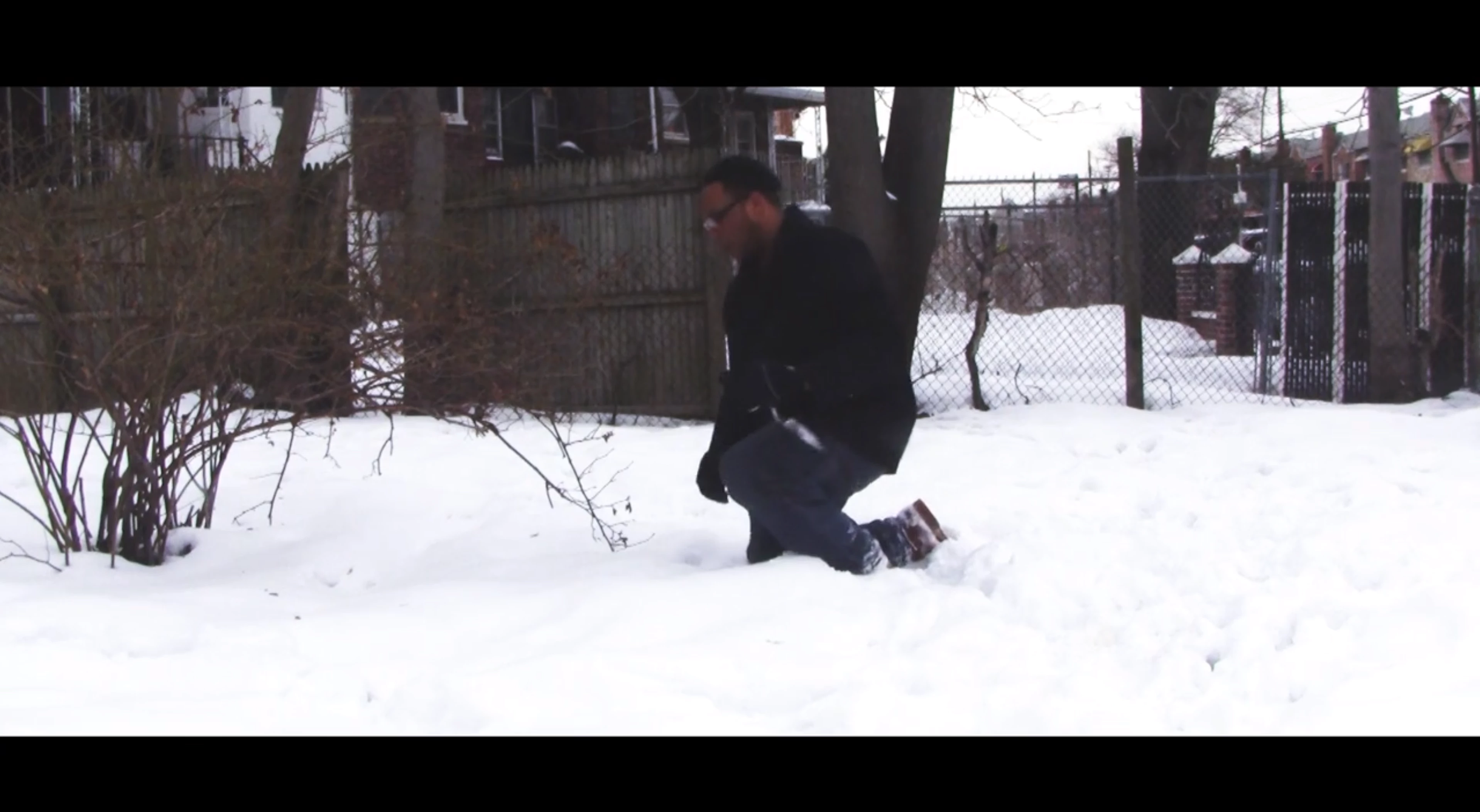

You’re shooting a video and you want it to have that Cinematic Look in terms of the black bars on top and bottom. So, in a 1920 x 1080 Comp, you physically add the black bars into the video, Like this:

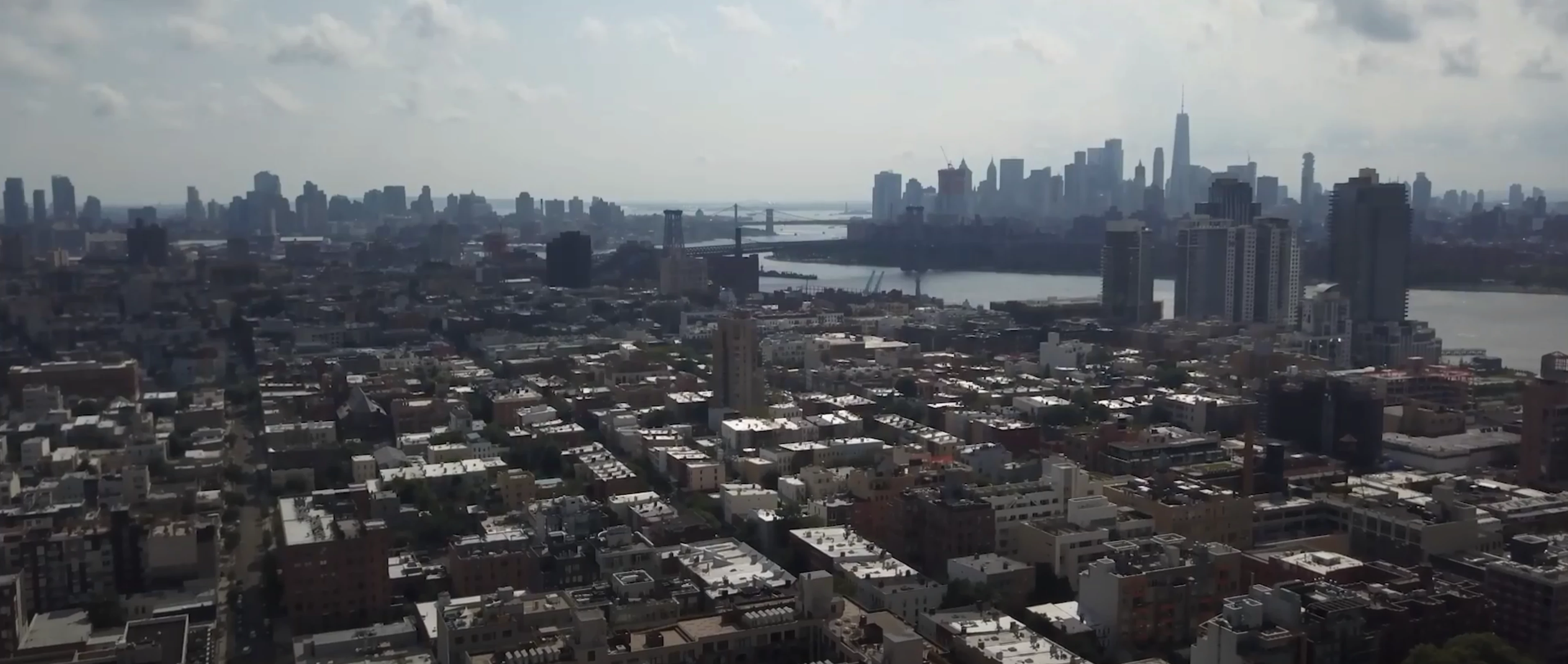

As you can see here, the video itself has that wide cinematic view, but the black bars aren’t in the video itself. In Premiere Pro, Sequence Settings; you set the Frame Size, Horizontal & Vertical to 1920 x 817. Like this:

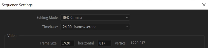

Now this is where the video stretching occurs. When you change the sequence dimensions in a Preset Editing Mode like “Red Cinema”, and then render the timeline, it will stretch the video, even though the Pixel Aspect Ratio in the Sequence Settings & the video file itself is the same. In this case the Pixel Aspect Ratio is 1.

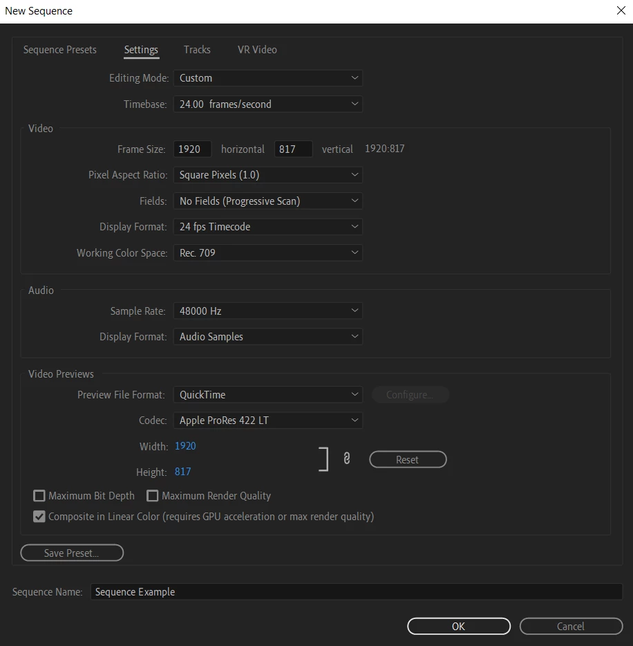

So, to change the Preview File Format, you have to set the Editing Mode to "Custom". The Preview File Format will be inaccessible if you’re in a Preset Editing Mode. After you set the Mode to Custom, go ahead and change the Dimensions to your liking, and then change your Preview File Format to “QuickTime” and your Codec to “Apple ProRes 422 LT” [See the Example Below of my settings].

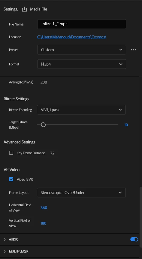

Correct answer Mahmoud219000024tiy
What fixed it for me was to Turn off VR Video under exporting settings, for some reason whenever you use an "odd" resolution in premiere it will automatically turn that on, i was using 1920x1920.

@Mahmoud219000024tiy how do I pay you for your comment about the VR export haha.. I've spent hours re-exporting only to try to avoid smashing my computer when I opened the rendered video.  Thank you thank you thank you
Mahmoud219000024tiyCorrect answer
November 2, 2023
