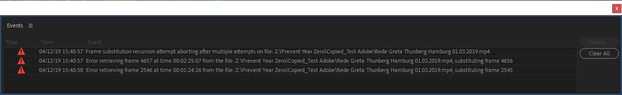

I switched the "video rendering and playback" to Mercury Playback Engine software only, like someone mentioned, and it worked!! YAY

Ensure footage is all set to "constant frame rate". All your footage can be 25f/s but some footage can have a variable frame rate if it was recorded on a different device/encoded separately/provided by a third party.

I know this is an old thread but adding this here as I didn't see it so far.
Same issue, after doing some digging, here's what I found:
Actual issue: footage has variable frame rate (the codec does not matter), you can confirm this by viewing properties of the clip in PP (it will say variable OR constant frame rate). Adobe does NOT (at least NO LONGER) reads footage exported with variable frame rates. Footage received was from a documentary project working with historial footage with a lower frame rate, therefore the editor rendered using "variable frame rate", hence my issue.
Fix: no need to re-encode. You can convert the footage to use a "constant frame rate" setting using softwares like Handbrake, I used a free trial of EaseFab video converter (here's a link: https://www.easefab.com/video-converter/). If using Easefab, here's a tutorial: https://www.easefab.com/resource/transcode-variable-frame-rate-to-constant-frame-rate.html#2 - it's ONLY FOUR SIMPLE STEPS.
I simply used the SAME codec of the source footage, but set the frame rate to 29.975. Adobe now reads it properly.
They should probably make a patch to automatically convert or just simply read footage with variable frame rates.

Thanks for the info. Since I downgraded to the 2020 version I didn't have any problem. I'm afraid to upgrade again... Using your solution, don't you get a loss of quality ?

No, I did not see a loss in resolution.

It's because your footage has an inconsistent bitrate. Look at some of the solutions here on the forum.

Variable Frame Rate is sometimes an issue, not variable bit rate.

Something that seemed to work for our team--moving the Media Cache and database off Networked Storage (read and write speeds exceeding 500MB/s) to internal SSDs (similar speeds) and in our online suites to internal NVMes (1500MB/s).
Although we're still left with some problematic files from time to time, this has dramatically cut down our frame substitutions.  Also purging the media cache as soon as problems arise.  It's just not worth struggling through it with manual offline/relink procedures.  It's honestly faster to just purge the cache and grab a coffee while it rebuilds.  YMMV depending on the complexity and size of your projects.

This is going to sound dumb, but the easiest solution is copy and pasting the video file in your folder and then importing that pasted file. It works for me everytime, but then again we could be having different issues that cause the same problems.

The problem, as they discussed, is the .mov container.  If you use it, you can get frame subs.  MP4 and MXF do not have this issue.  If you have an MOV in a project with MXFs and MP4s, that can actually cause the MXFs and MP4s to throw frame subs.  It's down the existence of MOVs in your project.
