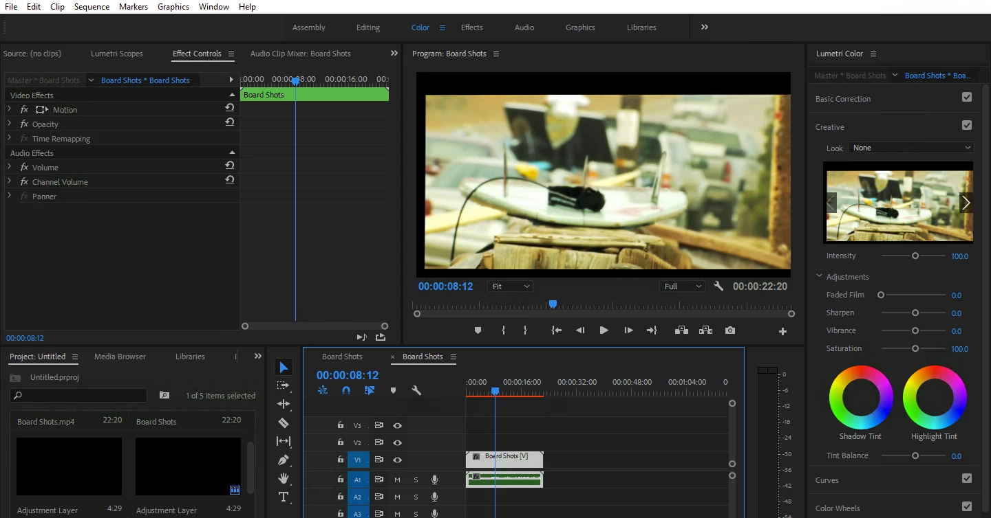

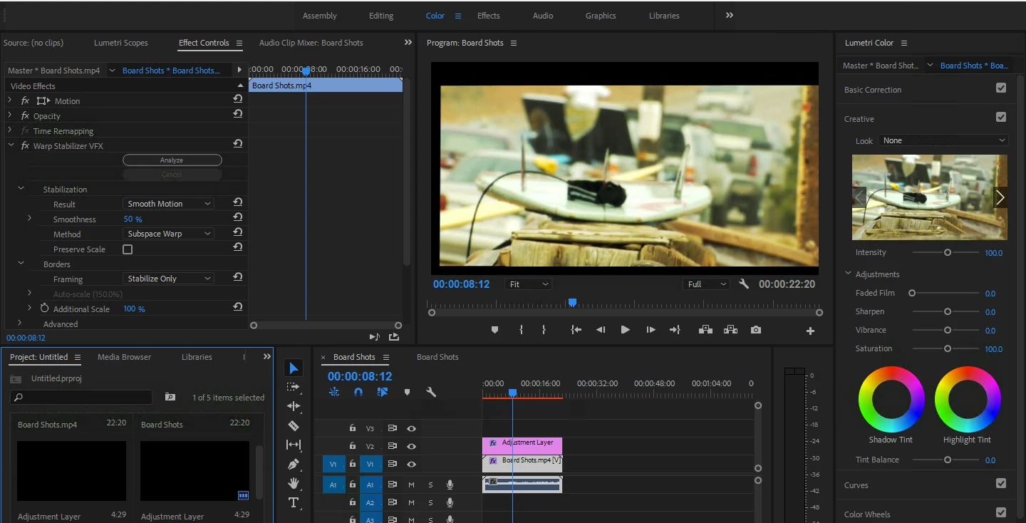

I test this today both on MAC & Windows premiere pro cc 2018 (12.0.0 & 12.0.1), I stabilized the clip using warp stabilized vfx set to stabilize only and than create a new adjustment layer > applied lumetri color effect. Everything worked perfectly fine.
Screenshot of the samples -
With Adjustment layer -
Without Adjustment layer -
