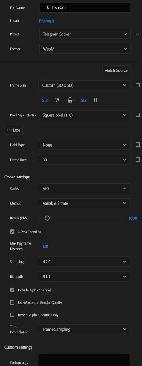

I have attached my export settings in case I made some mistakes.
I tried to increase bitrate, change codec method, decrease keyframe distance. None of them works

Just found out that changing the following will result export freeze halfway forever (Pr still responding and I can cancel with no problem), or exported file completely damaged and unreadable:
Codec method other than the default variable bitrate or higher than 1000kb/s
Max keyframe distance smaller than 72
Sampling other than default 4:2:0
