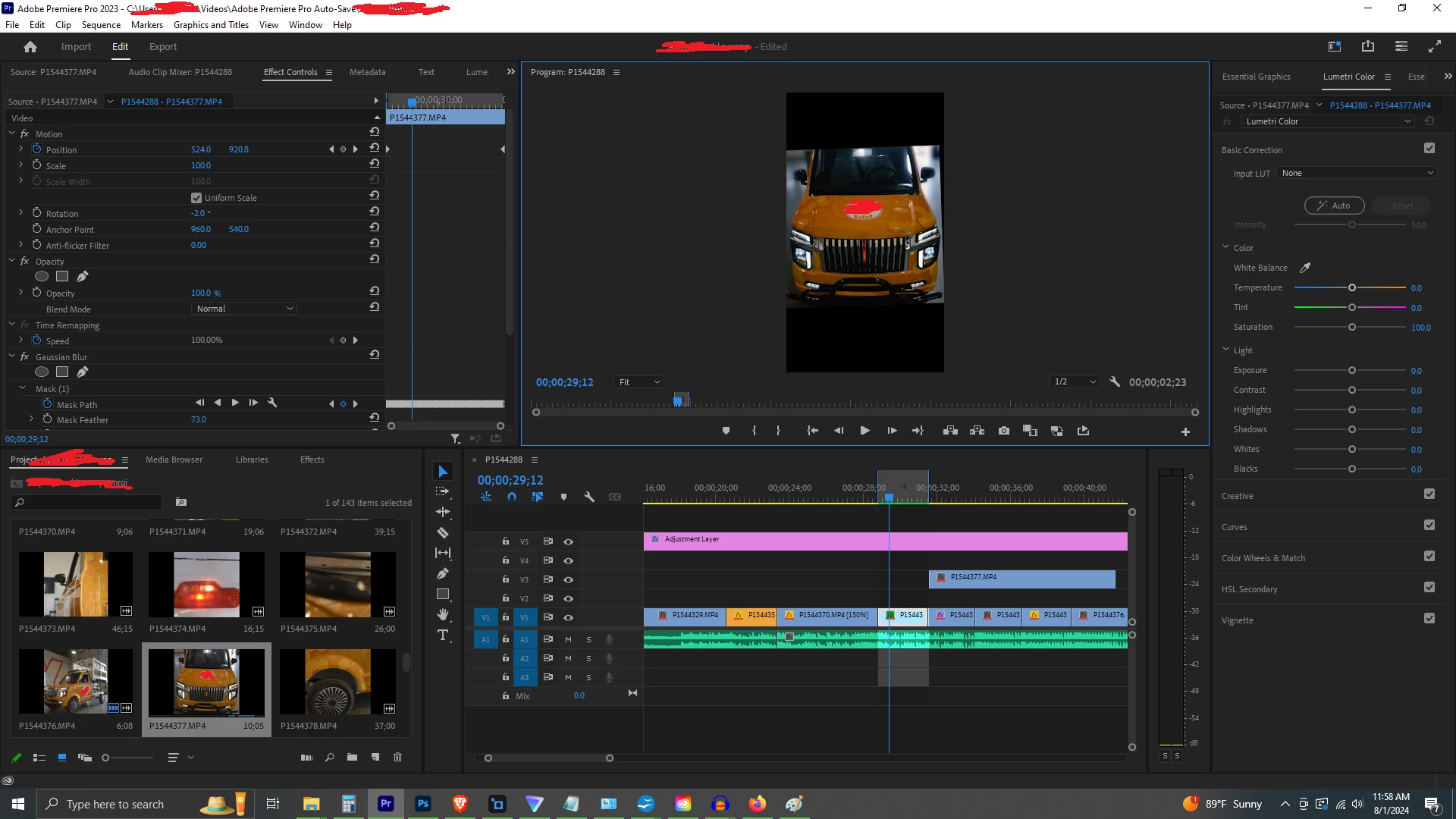

What the heck is happening?
Trying to add a blur mask for some reason also crops the video file to a 1x1 square??

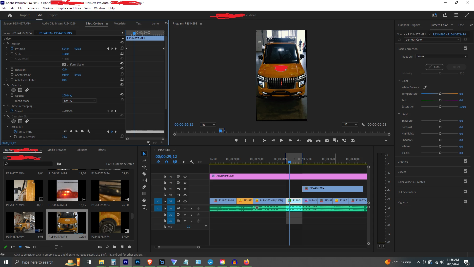

Here's what the footage looks like with the mask disabled.
And here's what it looks like enabled:
I tried to duplicate the clip so I could attempt a work-around using a opacity mask instead, but turns out the opacity mask creates the same annoying problem.

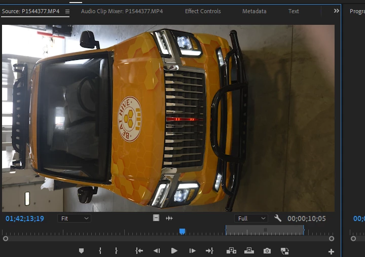

BTW: That picture you labeled "This is what the clip looks like with no rotation", so that looks like a landscape / normal video with some problem with it, if it is showing landscape there?

If I apply a transform effect (instead of just using the rotate feature already found by default under effect controls) I can apply that effect to every clip thereafter in the bin via copy/paste. Otherwise, I would have to manually rotate each clip 90 degrees after dropping it into the timeline. They all have to be rotated because the destination platform is Instagram Reels, and the footage was shot accordingly (camera held vertically.)

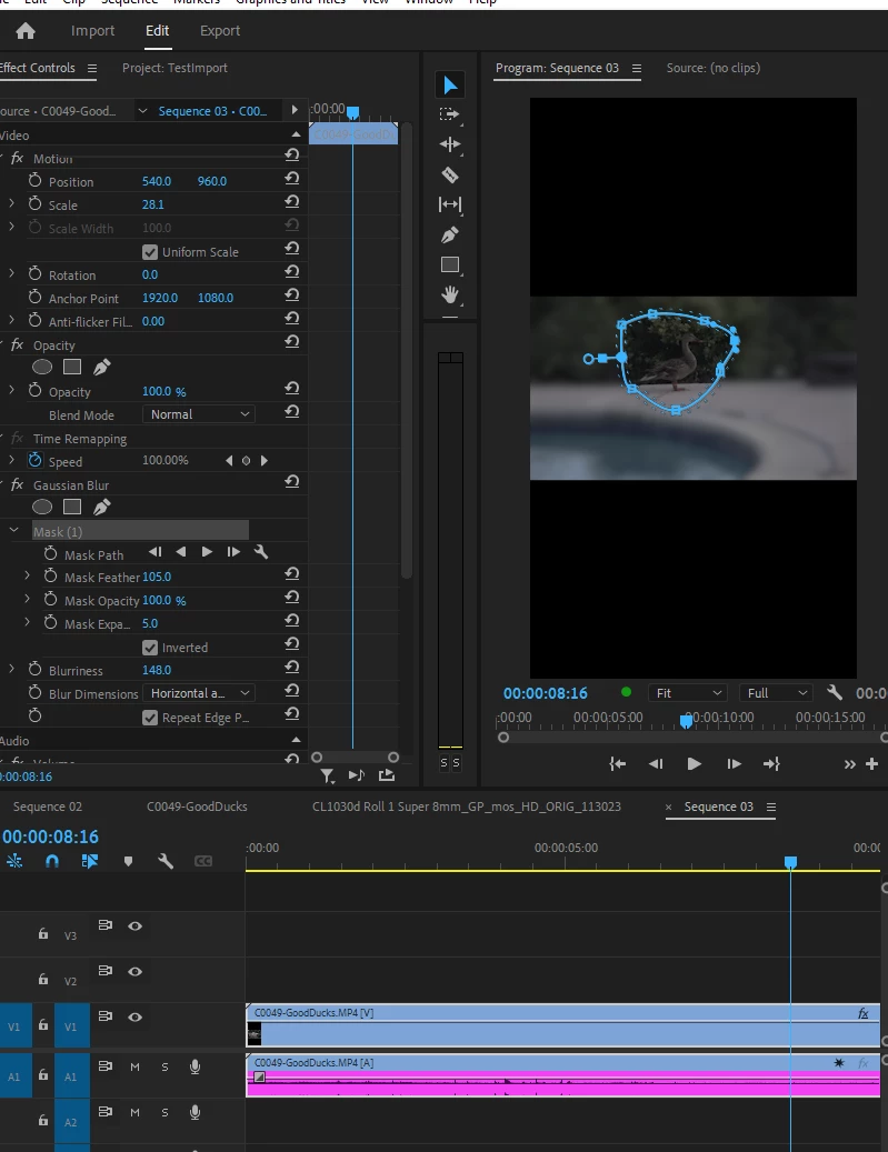

I can't duplicate it:

Your mask looks like very many nodes around the mirrors. Can you try a new project, drop that clip in and try the mask again very simplified. As an aside: (So, it looks like it's a standard video you are editing vertical. )
brendano16310974
August 1, 2024
Yes, it's a clip that's had a transform effect to rotate 90 degrees to make it suitable for insta reels.
Copying the clip into a new project yeilds the same results. Literally any mask shape (rectangle, circle, etc) seems to cause the problem.

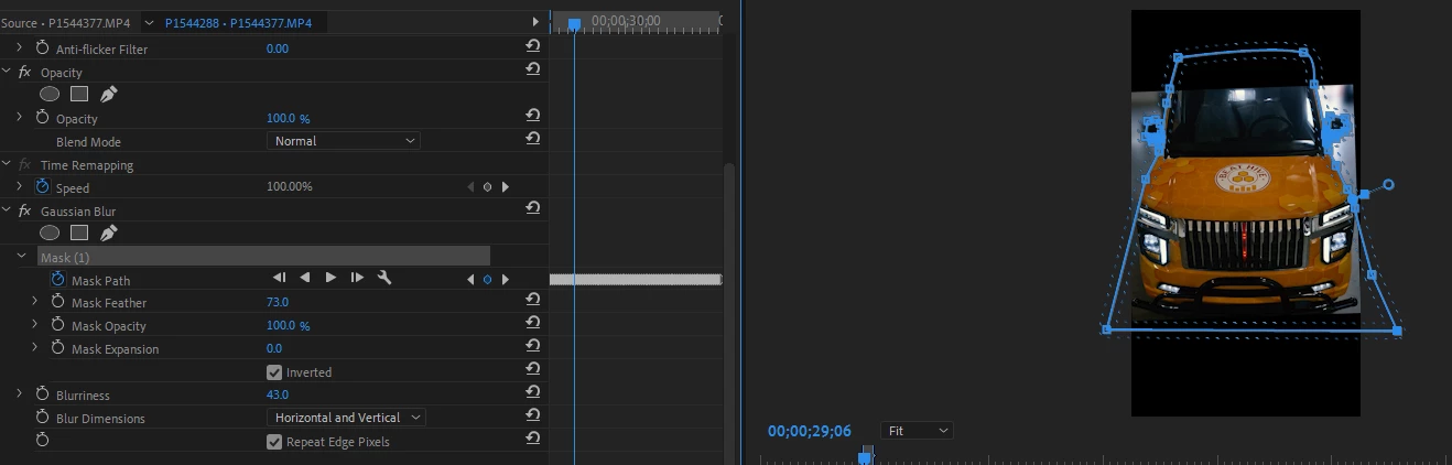

The mask goes around the car, right? So you can blur the background. Click on Mask(1) so we can see the mask.
MyerPj
August 1, 2024
hmm... OK, so I see what you are talking about. Do you need to Invert the mask? We don't see all the controls for the mask in the screenshot.
brendano16310974
August 1, 2024
Here's the mask controls. I need to invert the mask so the rest of the garage is blurred out (the glitch/bug seems to happen regardless is the mask is inverted, or if repeating edge pixels is selected)

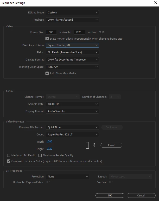

Maybe get your scratch-out tool and post a screenshot of the sequence settings?
brendano16310974
August 1, 2024
Here you go
