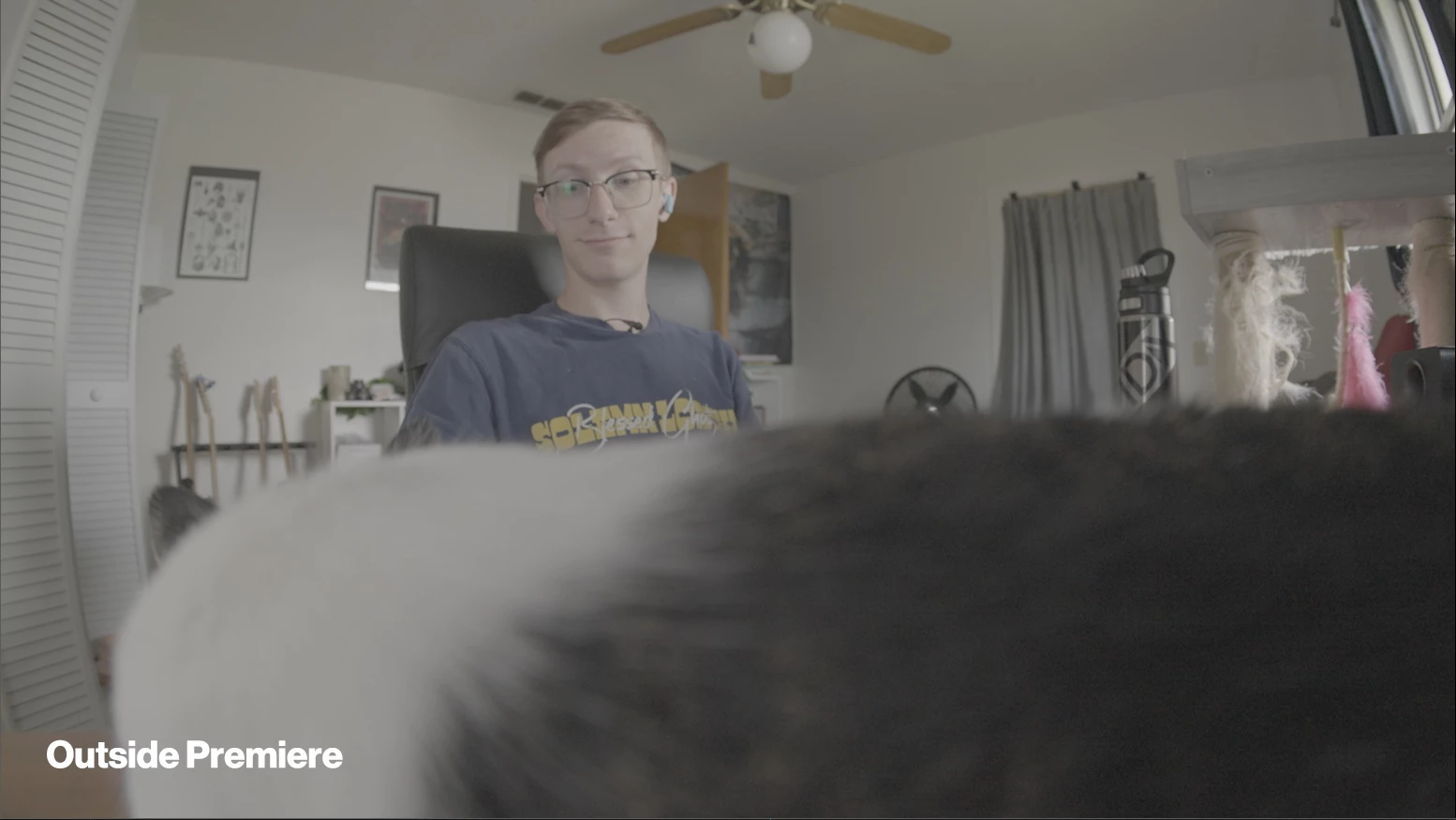

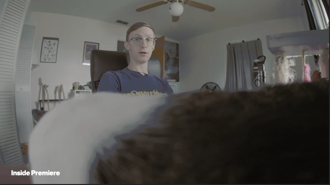

So today I encountered a weird issue inside of Premiere that I have not experienced before. I uploaded some footage that I had recently shot, but the footage did not look correct. I thought that maybe there was something wrong with my camera or some type of corruption when transferring the footage from my SD card to my computer, but the files are fine when viewed outside of Premiere. The problem does not affect the exported footage either so it is just the way that Premiere is displaying the footage.
The only major thing I've done to my computer since working on my last project was use a monitor calibrator and calibration software to calibrate my monitor. Although, I don't necessarily see how or why that would affect how Premiere displays video footage. Thought maybe someone here might have an explanation or some advice on some other possible culprits for this display issue.

I have found a workaround for the time being, but it isn't perfect. I deleted some old calibration settings from my windows computer and then I turned off 'Display Color Management' inside of premiere (Which was greyed out earlier). While this does fix the weird color shift issue, it does affect the videos I work on. I compared an exported version of my video to what I see inside of Premiere, and the exported version is slightly darker and more saturated. It could have something to do with the compensation LUT I apply during exporting, but it usually makes it more accurate to what I see inside of Premiere, not less.
