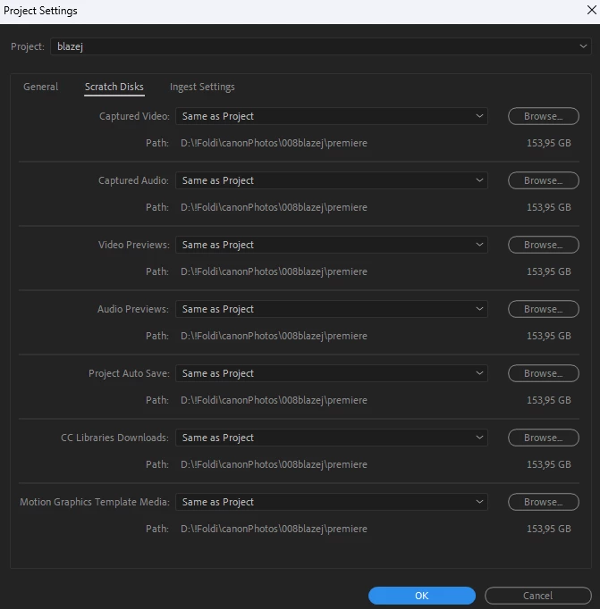

I have a strange problem. During editing, I use two SSDs—one where I have Premiere Pro installed and the cache folder, and the other where I store all the assets for editing and where I save the footage. I also have a third, large HDD where I save finished projects that I no longer return to. The problem is that when using Premiere Pro, it shows 100% usage of the HDD, which causes my whole computer to lag. I don't understand how this is possible since the projects on the HDD haven't been opened since being transferred there.

Based on what you've said about where PPro and your media live, we have no idea why PPro would be making your HDD busy.
Is any other software running, while you're resizing sequences in PPro? Does the scratch disk paths of any open projects, point to the HDD?
October 11, 2024
I was changing sequence settings, to a smaller size
