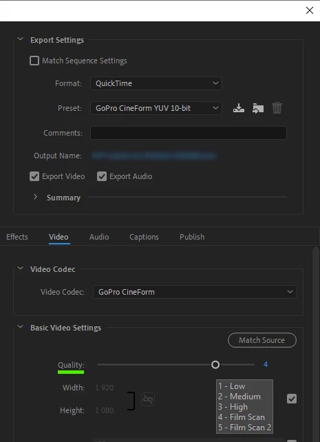

    Cineform is about 235 Mbps from what I understand and is closer to Prores 4444 (might be overkill)
    Worth mention is that one have a Quality slider for all CineForm exports. I get  48.4 Mbps when set to 1 (Low) for 1920x1080 25 fps and 124.3 Mbps when set to 5 (Film Scan 2). I started with the GoPro CineForm YUV 10-bit-Preset. I get even larger files if i use any of the 12-bit Presets.
    Point being, CineForm is not using only one fixed bitrate for every export. The end user have lot´s of control over the export and file sizes when using CineForm as a export codec. 🙂
