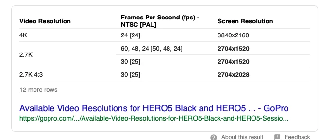

What are the pixel dimensions of the original source files?
According to this, GoPro 2.7k 4:3 footage is 2704X2028:
You would normally  want your proxies to be an evenly divisible reduction, such as 1352x1014 (the original dimensions divided by 2, for example) to maintain the source aspect ratio.
