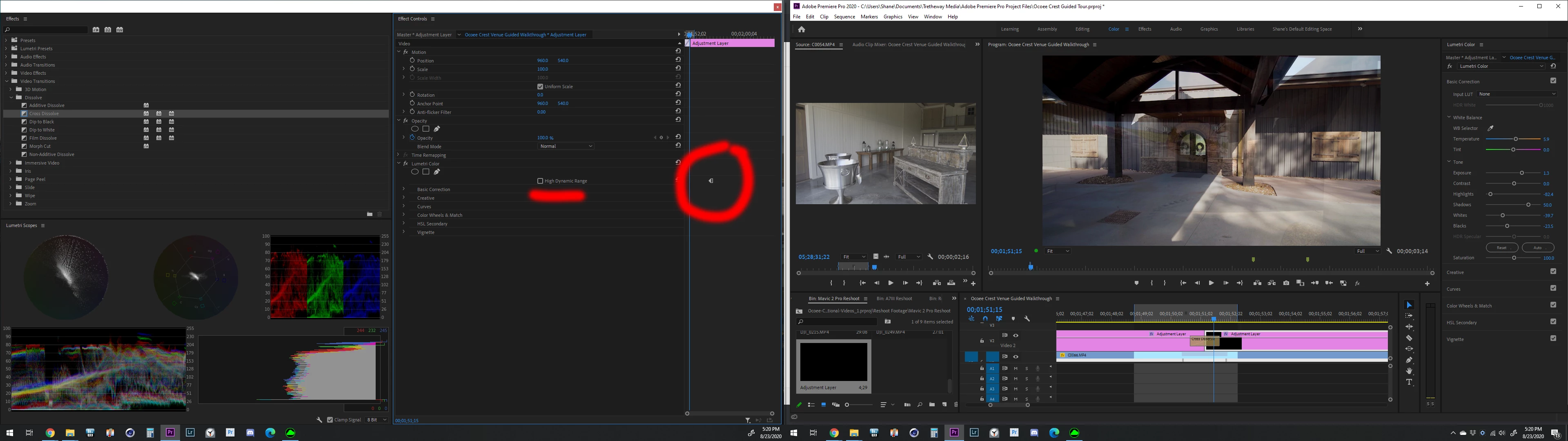

I was able to solve this exact situation. One of your cross dissolve layers has a High Dynamic Range Keyframe added to it. You probably accidentally checked the High Dynamic Range setting somewhere along the way and it created a keyframe, causing (for some unknown reason) a freeze frame to occur for the length of the transition. Simply delete that key frame and you will be back to normal! I'm sure you've moved on from this, since it's been two years, but I hope this helps someone else in the future!
