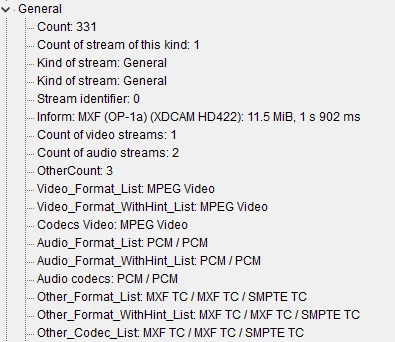

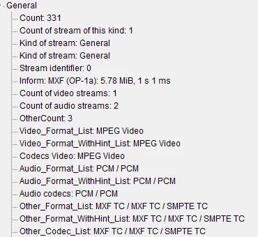

except for checking the smart rendering option, all videos under 2 seconds are simply MXF(OP-1a)
when checking with MediaInfo. In reality, it clearly says MXF(OP-1a) (XDCAM HD422). Reference images are attached below.
Attached incorrect images
Attached correct images

This could be more related to MediaInfos software and not Premiere Pro. The data images you posted just may be how Media Info chooses to deal with shorter clips like you said. Both images show the MXF OP1a container format the longer file just has the XDCAM HD422 codec listed as well. The MXF is a container format and the codec is XDCAM HD 422 which is typical format you listed you were using which is XDCAM HD 50. Both files you export from Premiere in reality are  MXF OP-1a XDCAM HD 422 but for some reason media info is just listing he info differently. If you would like to send me two test clips I could also test this out on my end.
