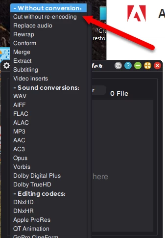

Another tool you could use is: https://www.shutterencoder.com/en/
It offers features to Cut without re-encoding, merge some video together. Etc. Much like what @ThioJoe is getting at but this with a GUI and is a tool to keep around for many uses.
October 1, 2024
@MyerPj Thank you - looks like a great tool.
