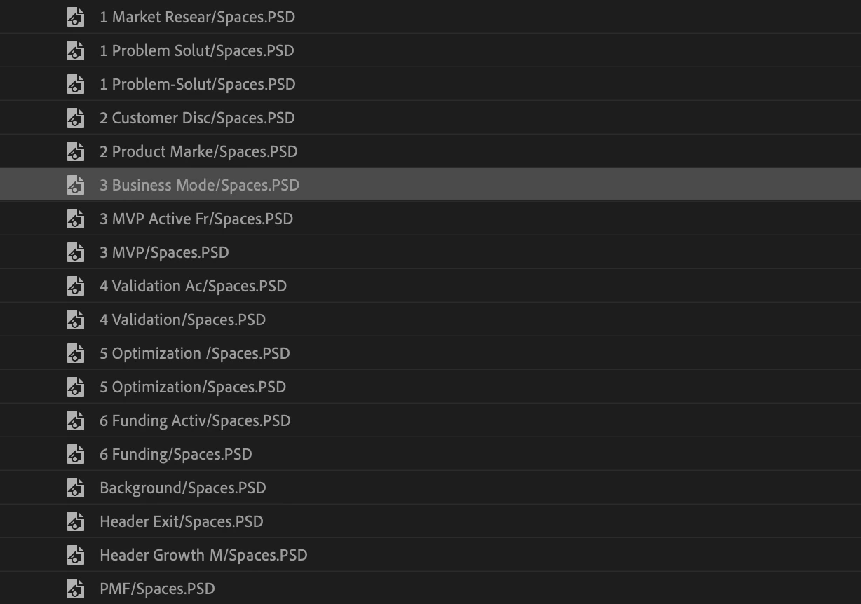

I just started to see that my imported PSD files layered names are getting shortened..
ie.   3 Business-Model-Red-Line is importing as.   3 Business Model/Spaces.PSD
Without the proper names it makes it makes it difficult to identify the layers I want to animate..
Has anyone experienced this? If so, have you identified how to fix this?
See image attached:
I'm using teams, I do not have ingest settings turned on...
Thanks

Thanks for the suggestion, but I have examples without the dashes and I'm experiencing the same thing. The good news is I think I figured out what's happending.. The files are saved on my local NAS Server. I did a test saving file on server and on local machine. The file saved on local machine did not shorten the name, the file on server had it's name shortened.  (See Attachcment)

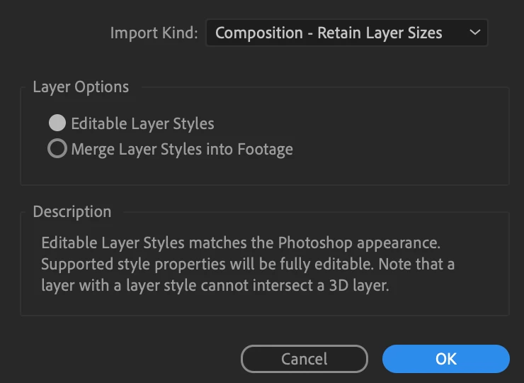

Hello, I had this problem too. If you select this when opening the psd file in After Effects, it will be fixed. If you open it as a merge layer, you will have the same problem.

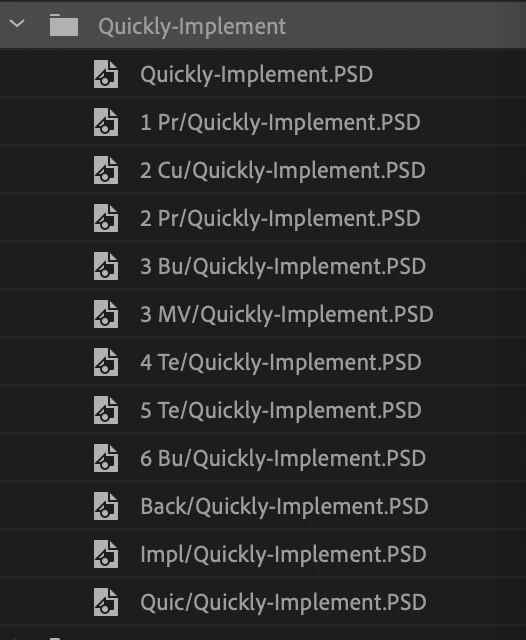

Hey Warren, this problem is getting worse, since layer names are shortened, the layers will start to intermittently disappear. I am guessing this what's causing the problem.. I am using a new Synology NAS 1621xs+ which is used by many creators. I have no problem with files using other applications, ie. Davinci Resolve... and I'm using a CAT 6A connecting at 10 Gbs
  • Can you elaborate onn configuration for video file server?
  • The files are all mounted as a volume on my iMac using smb
  • The file names are not long...  See attachment..
It looks like I'm going to have to import all files directly from my Samsung T5 SSD which is synced with my server which  doesn't appear to shorten the layer names  vs  using the smb volume.  This is a bummer, because I'm going to have to fix tons of work. However, I would really like to identify the issue because I have a teams account which is suppose to support file sharing over the network for it's Productions Features.

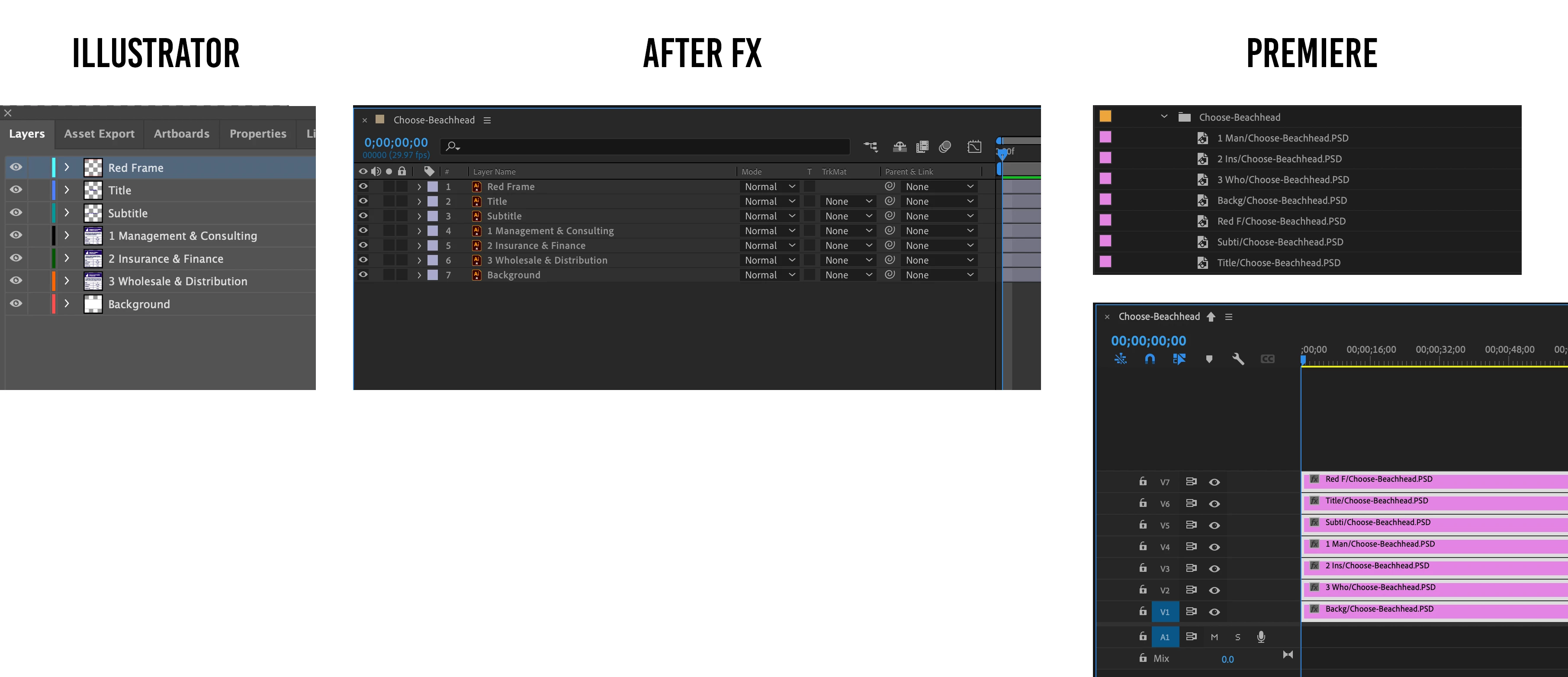

No Slashes in name.  Here's the work flow.
1. File Created In Illustrator - Vector Graphics
2. Opened In AfterFx
3. Exported from After FX to PSD
4. Opened In Premiere  - Layer Names shortened.  This seems to happend intermittently as sometimes the names are not shortened.
See Image...

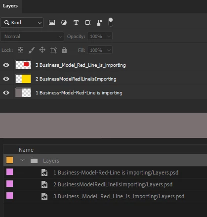

Averdahl
October 9, 2021
quote
By @Visual FX Artist
I created a psd file in Photoshop 22.5.1 and imported it as Layers in Premiere Pro 15.4.1 and it seems to work here. I did some tests with the name, iow dropped the dashes to see if it was the issue but it did not matter. On the image you can see the layers in Photoshop and in the bottom how they are named in Premiere Pro. I am on Windows and guess that you are on a Mac or using different app version than i do. Right or wrong?
Visual FX Artist
October 11, 2021
I am generating the PSD from After FX via export. I do this as it structures the PSD layers the way I want for animation in Premiere or After FX
See Image.
