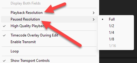

I'm having trouble figuring out while playing back footage it will shift to a green tint. I did update to 23.5.
defaultarzr4c1a7s0yCorrect answer
September 6, 2023
Ok, so the Playback and Pause resolutions where the same, BUT High Quality Playback was unchecked. Selecting the High Quality Playback seems to have fixed the issue. Thank you!

September 5, 2023
There are settings for those two things, playback and paused... set them both to the same, it may help. (under the WRENCH icon on the Program montitor.
September 6, 2023
MyerPj
September 6, 2023
Good, yes, it's good keep that on. I've even heard reports that there were performance issues with High Quality Playback off.
Well done! 🙂
