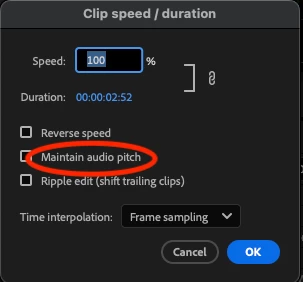

When using "maintain audio pitch" with "Clip Speed/Duration" the resulting audio is unusable
I have to make slight adjustments to the speed of video clips for length on a regular basis.  If the clips have sync audio I can't use "maintain audio pitch" with "Clip Speed/Duration" because the speakers voice will have a terrible digital delay effect added.  This has been occuring for years now.  If I turn off "maintain audio pitch" and instead use "Pitch Shifter" it works perfectly fine with zero delay artifacts.  If I send the audio to Audition it works perfectly with zero artifacts.  Can we please have "maintain audio pitch" fixed.  if not can we just have it removed as an option?

No.  I have a 30:15 second clip of talent speaking and I want to make it 30:00 seconds.  I set the clip speed to something like 98% then I check maintain audio pitch so they don't sound like a chipmunk.  As soon as I check this box the audio sounds like it's in a reverb tank.   I don't have time to create a video right now but I will try when I have time.
