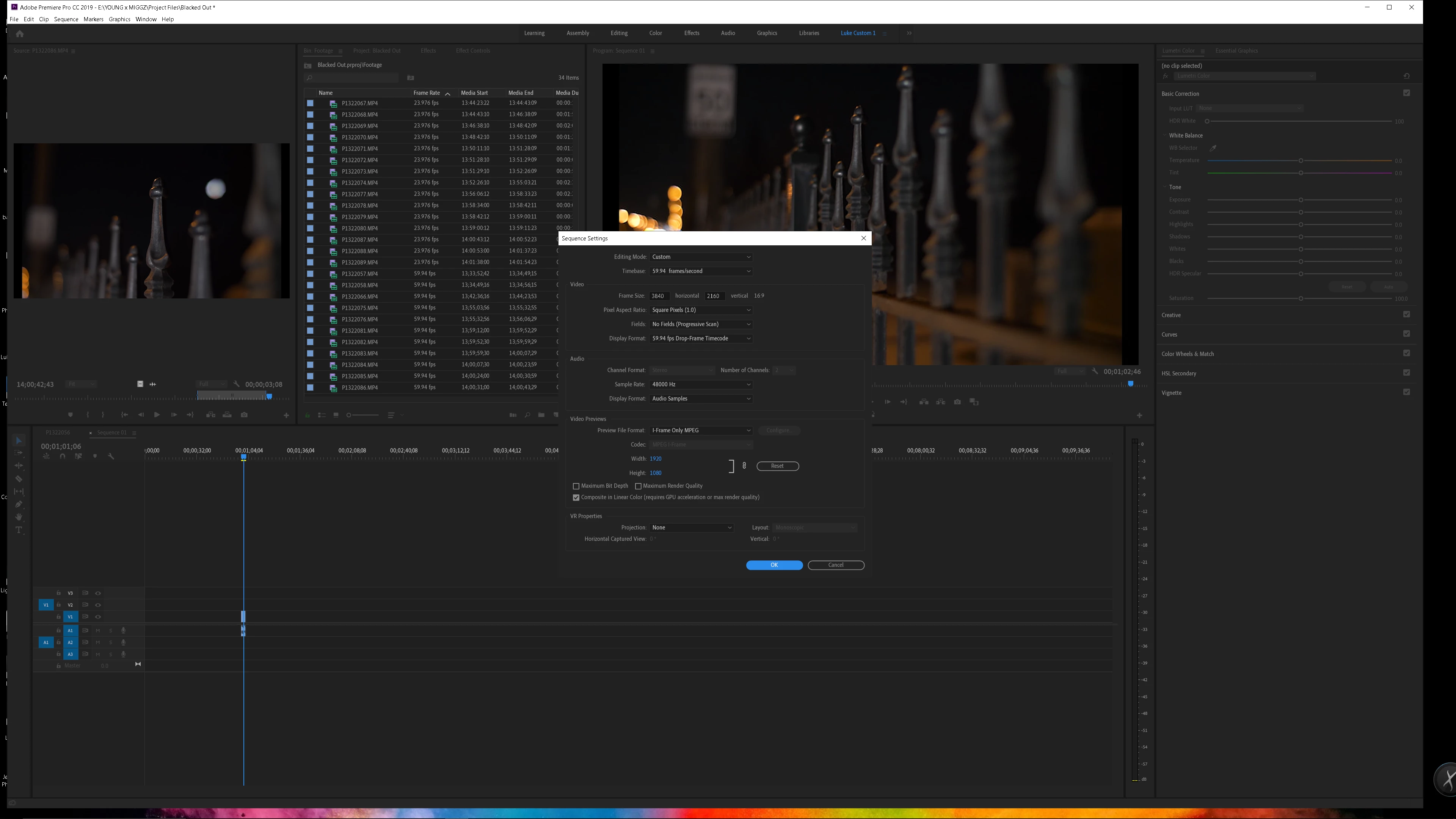

I'm having a weird issue with PP at the moment. Getting some black bars on either side of my footage in the program monitor. Footage is 4K, sequence is 4K. Same thing happens when I resize the footage in a 1080p sequence. When exported at 4K the black bars do not appear in the video file. It's not a huge issue but it's very disorienting when using things like warp stabilizer or creating digital zooms. On the a previous project I cropped everything in to 107% scale because I thought for some reason the resolution of the footage was the issue but now it's looking like some kind of Premeire error.

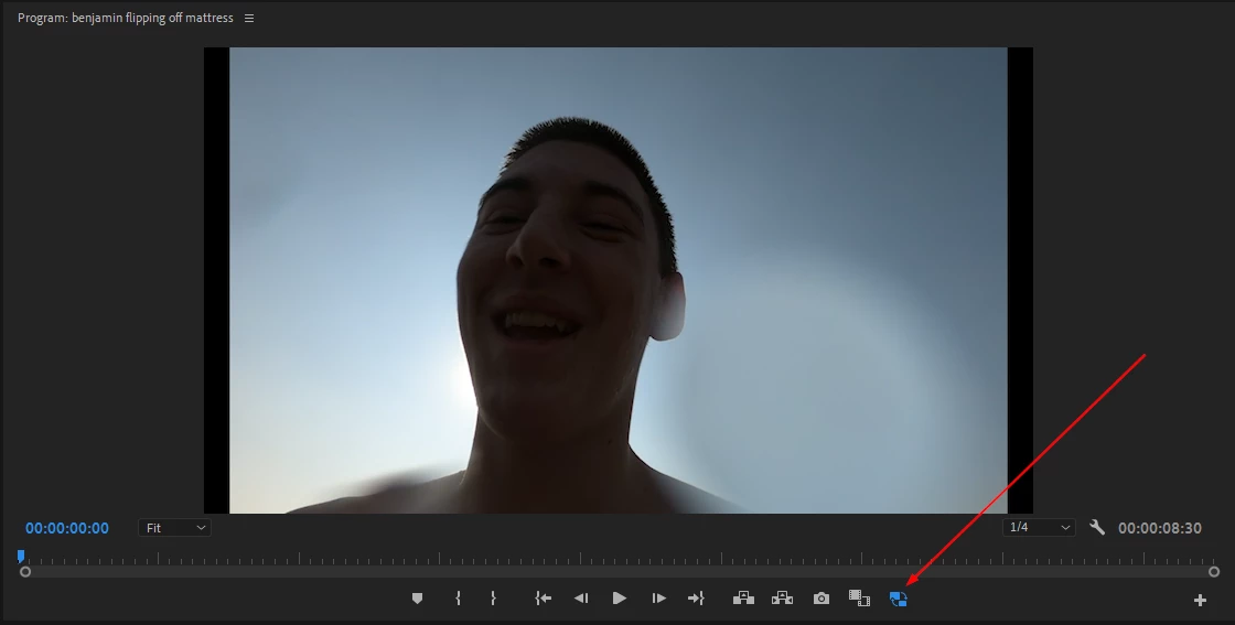

    I know this is an old question, but I figured I'd leave my comment here in case someone else is having this issue.
    When I imported all of my footage I created proxies for all of them.  Once the proxies were done, I created a new sequence from a 4K GoPro clip I had imported and the black bars on the side showed up in the program panel.
    When I shut off the "Toggle Proxies" (shown in the screenshot above) my clip now looks normal without any black bars. So the problem is more specifically the aspect ratio my proxies were created in and since I have Toggle Proxies enabled it was showing me the proxy with the wrong aspect ratio. You may be doing something similar without realizing it like I was. I even went through and scaled all my clips to 107% to get rid of the black bars that were never actually on the exported media since it wouldn't be using proxies.
    I hope this helps someone and saves some frustration.

    March 18, 2019
    Your sequence setting is not 4K but UHD, slightly different.
    Post screenshot of clip analyzed in Mediainfo in treeview.
    MediaInfo windows

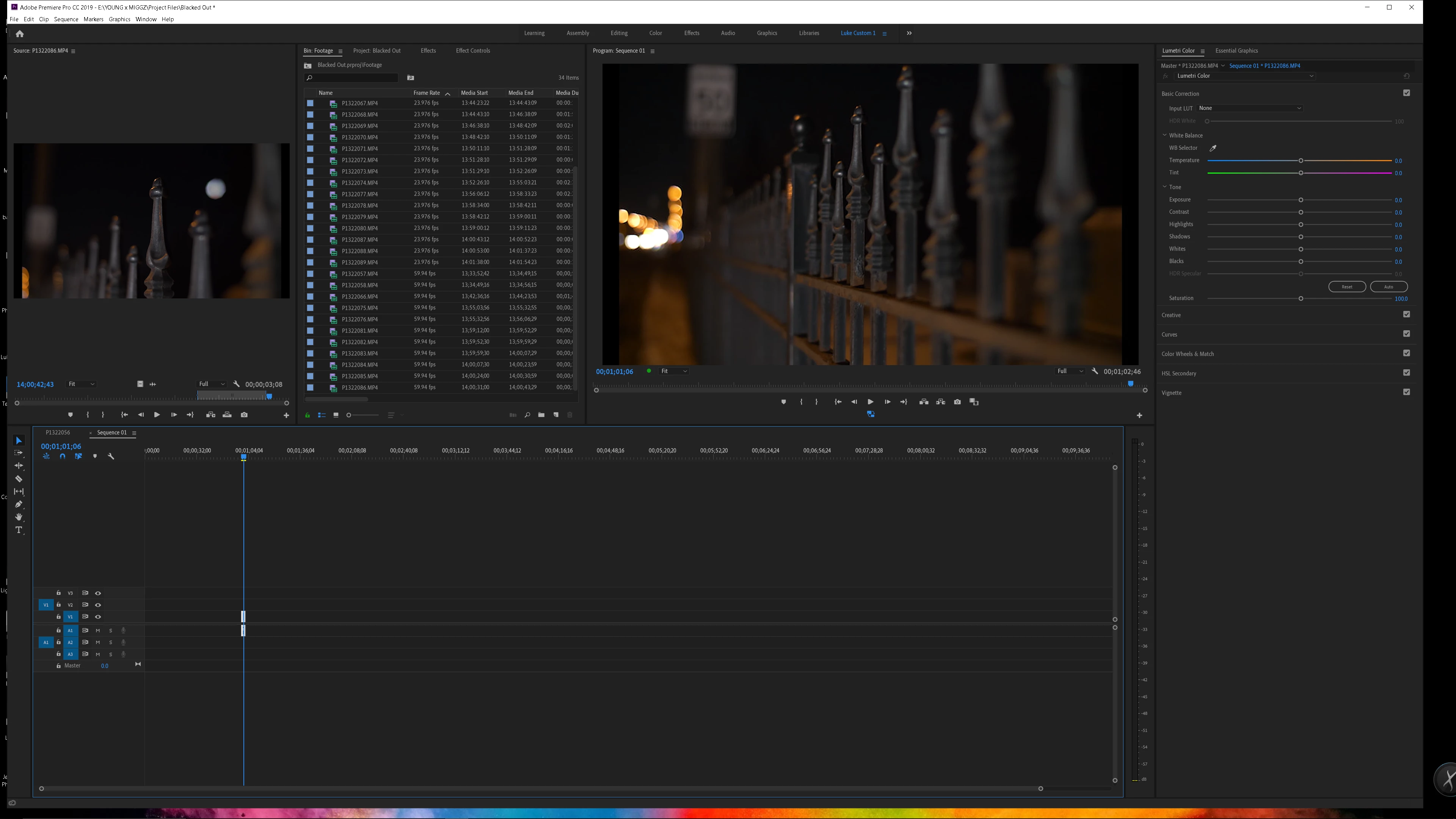

    Ann Bens
    March 18, 2019
    Just looking at the source monitor: those black bars might also be on the original footage.
    Post screenshot clip properties in Pr.
    March 18, 2019
    UHD is the consumer version of 4K at 3840x2160, while 4096x2160 is Digital Cinema 4K. If your source is the latter, that is not a 16:9 aspect which may explain the black bars.
