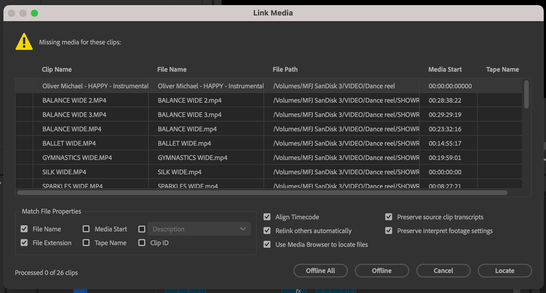

This is probably true for other CS software too but it happens in Premiere mainly.  I'm sure we've all had the scenario here mid-edit an external drive hokding some or all of the files for a project gets knocked and ejected, and so Premiere loses the files until you relocate them manually.  It does a good job of finding all the files once you've pointed it to the first one it's looking for (thanks Adobe!).  But my question is why can't it find them automatically itself.  When I plug the drive back in the parh to the file/s is the same.  Premiere literally lists the original path of the file in the search bar.  What's the reason for it not just automatically reconnecting to those files which are exactly where they were moments ago?
(This question is aside from the obvious suggestions of a) don't work on an active project on an external drive b) don't let it get unplugged in the first place!)

couple of thngs:
1) a box saying "would you like to reconnect these files" (there's already a box asking you to search.  Why not default to the location it already knows it's in.  I just click "OK" instead of searching where it already knows they are.
2) Can you give me an example of when you might not want that?
(It doesn't have to be passive / automatic - just default to suggesting the original location and then I click OK if that's what I want)

"Premiere does not know where to look if disk is reconnected"
Except is specifically has a note of what the drive/path of the file is when you go to search for it.  It "knows" where it was, but instead of defaulting to that location (for me then to confirm or reject - which coveres all the other points about why you might NOT want to go to the same place) it defaults to nowhere.
I'm just saying as far as I can see there is no reason why defaulting to the same location it used to be in can't be the norm.   If i'm reconnecting to a new drive / working on a shared project or whatever, I would need to reconnect anyway and go through these steps manually even without the drive disconnecting.  However if the drive where it used to be is reconnected, why can't Premiere make that it's defult suggestion?  I can still choose another folder if I want!

example of the "link media" window, showing that Premiere knows where the files were.  So why not just look there in the first place!
