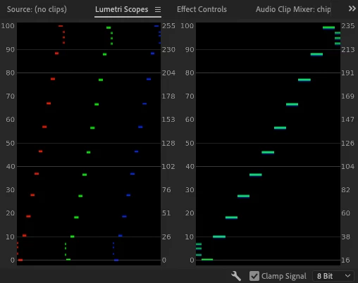

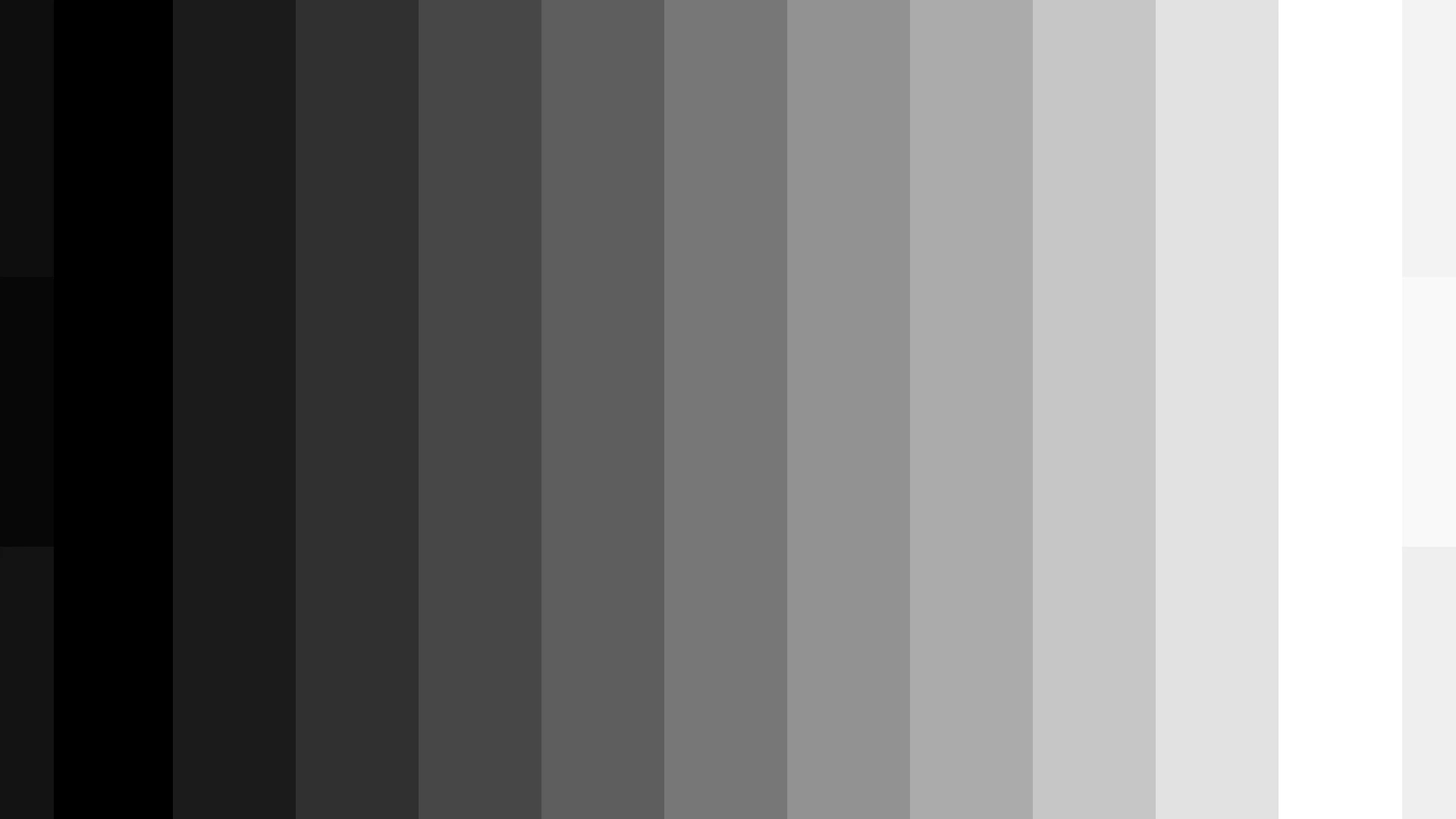

I created a simple 10 step chip-chart in Photoshop as a demonstration to a student of how to use the Lumetri scopes in Premier and noticed that the values don't match up between Photoshop and Premier.  In fact, only the 0% and 100% values line up.
The 10% bar comes in at about 11%
The 20% at about 18%
The 30% at about 27%
The 40% at about 36% etc...
Until the 90% bar is back up to about 89%
Is there a reason for this?  Please see the attached images.
When I use Premier Graphics program the bars come out exactly right.

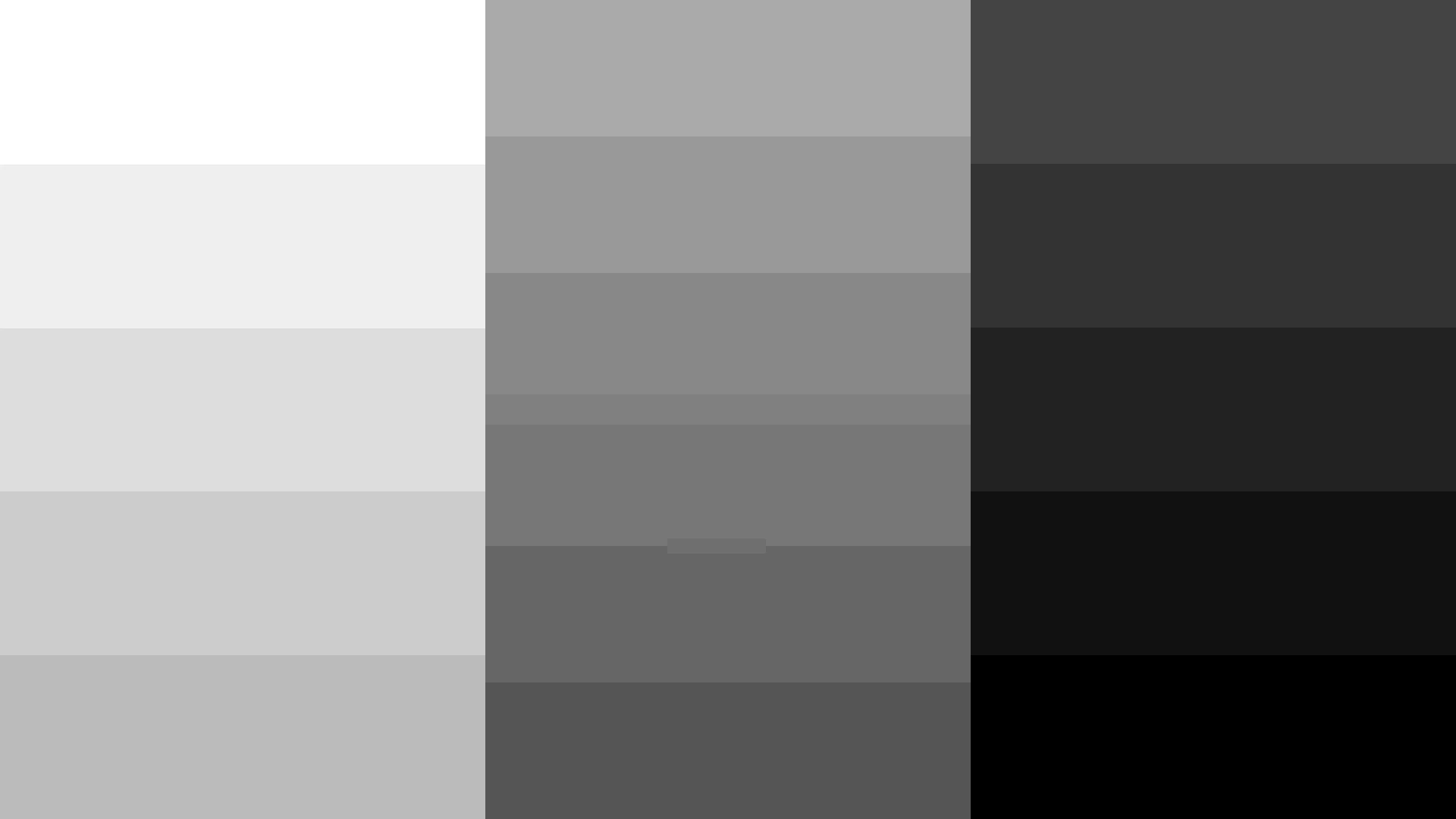

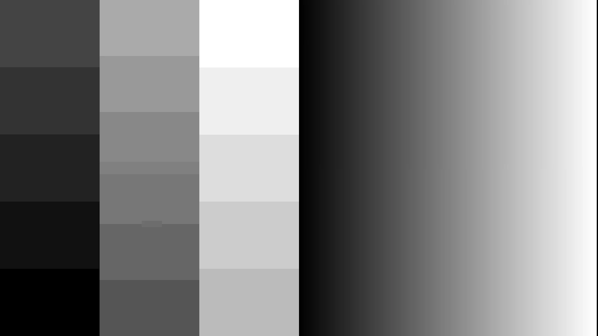

I created a chart in Premiere using the EGP ... just made a series of rectangles, filled them with white but set brightness of each box with a mask on so that was all that was showing and watched the scopes.
This was in 16 equal separations for brightness for the main boxes, with a narrow one at 55 and a small box at 45. I've used this coupled with a ramp as below to test how say LUTs are modifying the image. Or what specific tools are doing when set a specific way.
Neil
