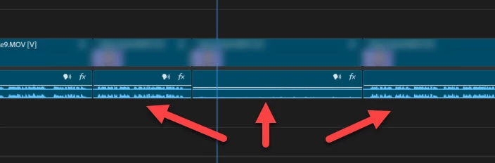

I have a video with audio from a wireless mic. I used Enhance Audio, which worked great for improving the audio. Now, for some reason, a clip of the audio is flat and won't allow me to enhance the audio.
Can anyone tell me why the audio looks different from the other audio, even though it's from the same recording, and why it won't allow me to enhance audio in this particular clip?

I found the solution. The Volume Level was set at a lower dB than the others. Once I adjusted it to the correct dB, the issue was solved.

Hi cluser2025,
Adding to Carlos Ziade's suggestion. Along with the Enhance Speech settings, could you please confirm if you have any other audio effects applied to that clip?

I found the solution. The Volume Level was at a lower DB than the others. Once I made it the correct DB it solved the isseu.

did you make sure that Enhance Speech is ticked for this specific clip when selecting it?
