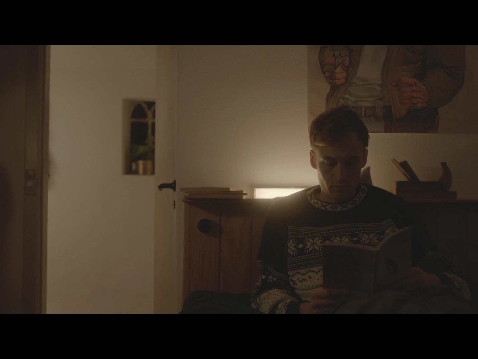

Hello guys,
I've been searching but ultimately cannot seem to find a definitive solution.
I'm editing a short film and it's my first time working towards a 4:3 output. It's shot on Alexa Plus:
Type: Quicktime Movie
Image size: 2048x1152
Frame rate: 25fps
I've made an adjustment layer with croplines for the workflow when working on the timeline in Premiere. When exporting I'd like to get it out in 1536x1152 - I should be able to do this without a loss in image quality, right? As I just crop some pixels off instead of stretching. The problem is, when I create a sequence in Premiere with the above-mentioned dimensions I get black bars in the top and bottom of my original 2048x1152 image in a 4:3 screen. I can scale it to fit the 4:3 image, but I imagine this creates a loss of pixels. Or am I wrong? I've zoomed 400 % and compared the one with croplines adjustment layer and the one that's scaled, and I seem to notice a small difference in quality.
Thanks a lot in advance.
- Thomas
    Correct answer Ann Bens
    I would make a custom sequence with 1536x1152. Drop the footage into this timeline.
    Enough room to reposition vertical. And no black bars on export.
    Most displays devices are 16:9. So you will get black bars on the side.
    May 15, 2018
    Thank you for the quick answer. And this rescale in the 1536x1152 sequence wouldn't result in a loss of image quality? I would just be readjusting the file back to its original vertical size?
    Best wishes, Thomas
    Ann Bens
    May 15, 2018
    No rescaling, just move it up or down to get a good frame.
