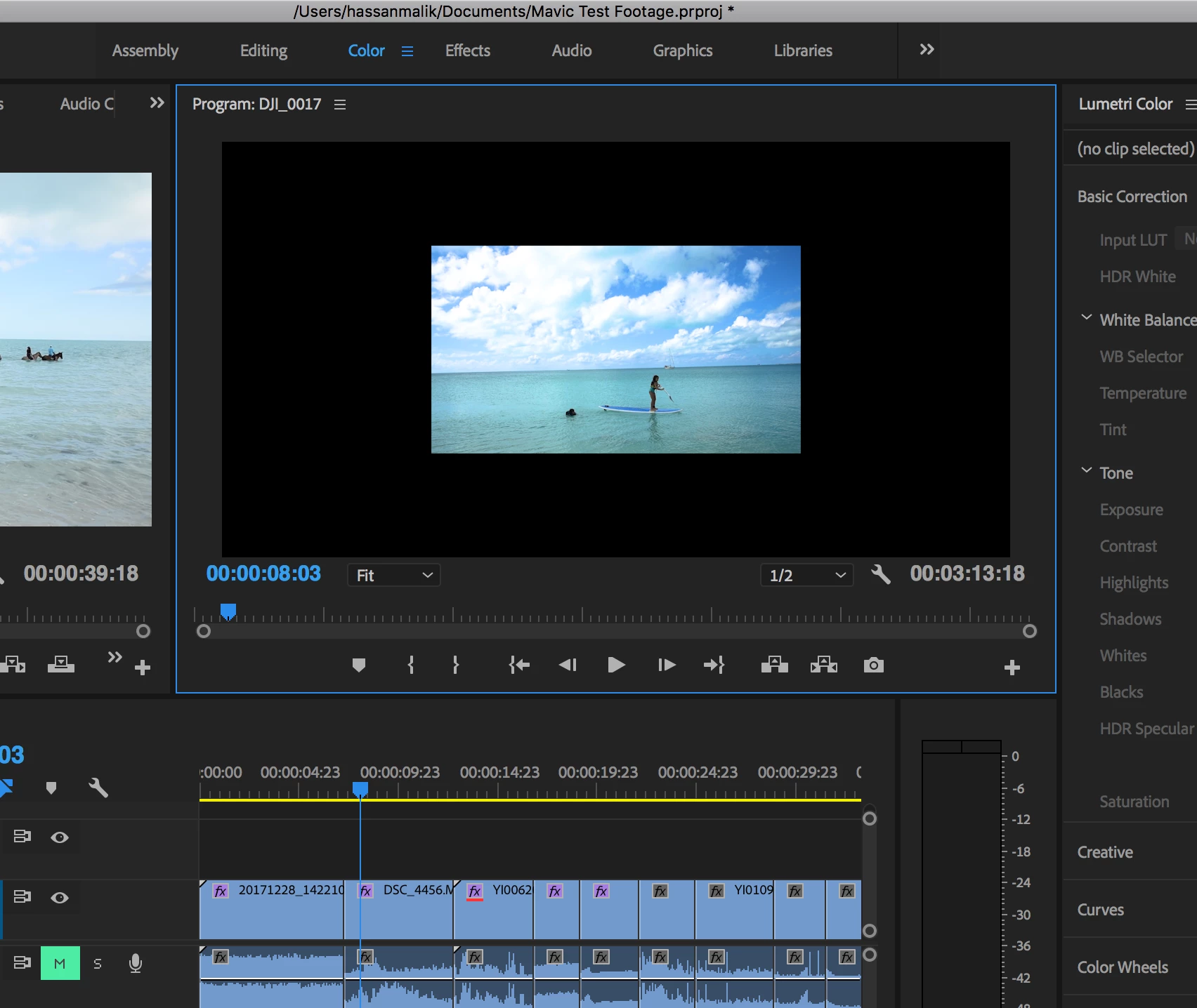

I'm new to Premiere and have a couple of different files such as Mavic drone (2k), Nikon 1080i. Exporting might be okay but I have noticed that in the edit window my Nikon footage is not filling the box like my drone footage is.
Is that something I should be concerned about when exporting?
Can I apply something to get my entire timeline on the same format?

    That looks like you have a project created from a 4k clip, therefore 3840x2160 or thereabouts, with a non-scaled 1920x1080 clip dropped onto the timeline.
    You could right-click on those clips, and use "set to frame-size" to scale that clip clear up to the frame-size of the timeline, but: it will lose a lot of quality "enlarging" it that much.
    It is more common to mix 4k/1080 media on a 1080 sequence.

    Is there a way for me to get it all down to a 1080 sequence or do I need to start this project al over?
    Also for the future, is it best to drop the lowest resolution clip I plan on working with first?
