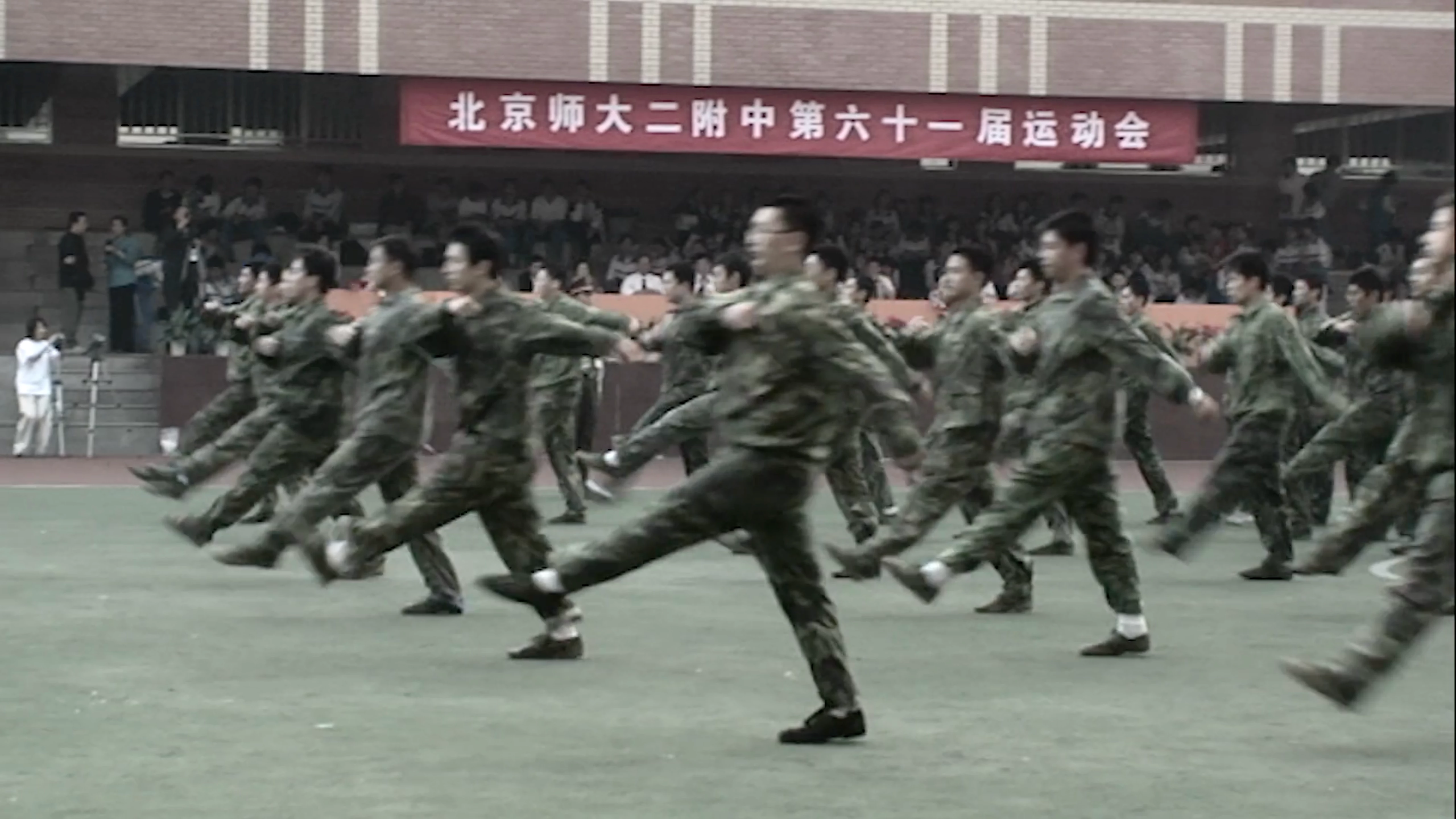

I've been working on a project for the past 1 1/2 years that originated on MiniDV tape. I set it aside for a few months and when I came back the footage now looks interlaced with "combing". I thought this might be a result of  Premiere Pro retiring tape-based workflows. Is there a way to fix this problem or a workaround?

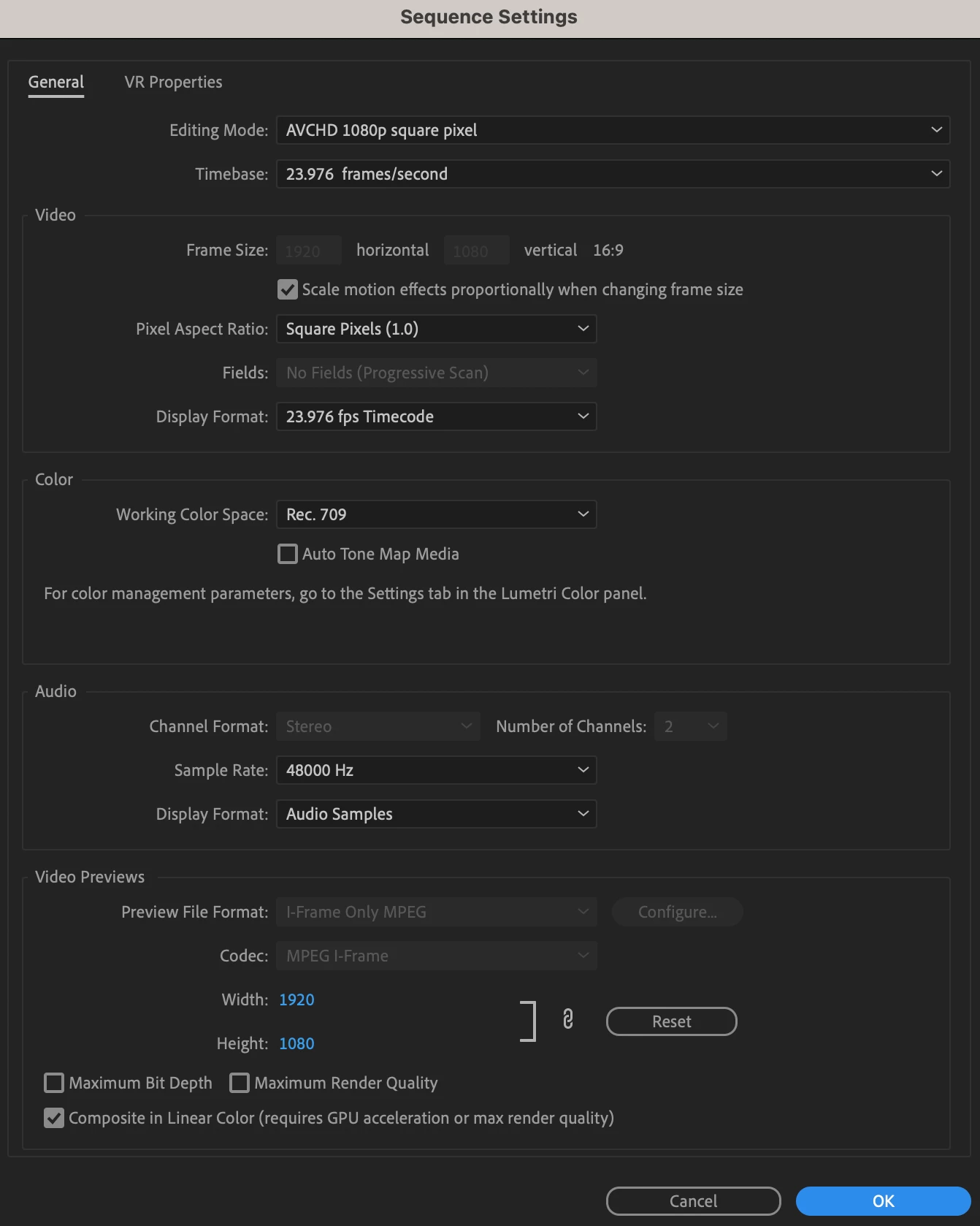

Thank you for your response! Do you mean the display settings on my monitor or in Premiere? Any suggested for how to set my display would be much appreciated. I'm attaching a shot of my sequence settings and footage.

Hi @Alifilms12,
Please post a screenshot of your sequence settings. That would help immensely.
Kevin
February 19, 2024
Thanks for your quick response. Here are a few images. I really appreciate your help!
1. Sequence Settings - I haven't changed any settings since starting the project.
2. Before - taken about a year ago
3. Now - This is happening with all Mini dv footage I bring into Premiere.
