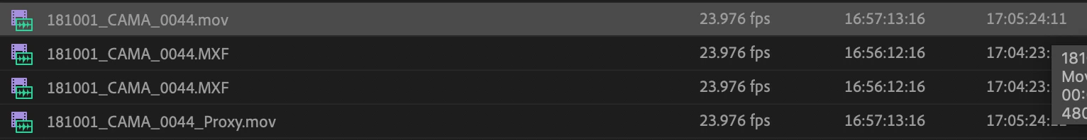

I also have this issue and I did use premiere to make proxies and also made proxies without premiere and here is a picture of the timecode for each. The proxies with screwed up timecode are the top and bottom and is exactly the same between the two proxies. And the middle two files are the same raw MXF file I imported twice, just in case.
Really weird as the frame rate was correct and it wasn't an issue with drop frame or improper frame rates. But I still think it might be how premiere/media encoder was reading timecode and it wasn't using the right frame rate since there was a different length of drift in different files with different
November 30, 2018
Some evidence: this clip is 2 minutes versus the one above which is 8 minutes. These clips are less than a minute different. The above clips are 1 minute and 1 second different.
