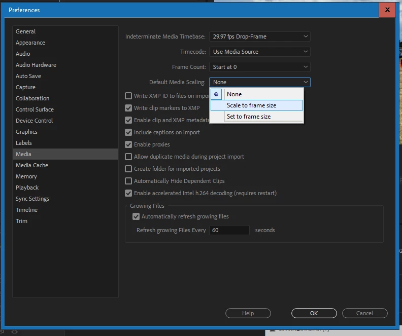

The Preferences option for default scaling is here ...
And you should both use the same setting. Again, I suggest Set to ...
This of course will not change an existing sequence, but will make future sequences align with each other.
And yes, for extant work, you would have to change the scaling on clips on the timeline 'manually'.
Another thing to be aware of is that if you have Premiere create sequences from clips in a bin, which clip you start with can matter. If your first clip is UHD, Premiere will make a UHD sized sequence. Adding 1920x1080 clips is then problematic.
Starting with a 1080 clip, you get a 1080 sequence, and adding UHD clips with "Set-to" as the default brings them onto the sequence full-frame.
So ... right off, making sure your sequence framesize is what you want is crucial.

Smrpix sounds like they're onto the probable problem. So check your sequence settings, are you both running the same framesize?
The other thing might be a preference issue ... both of you should make sure in the Prefs that default scaling is set to the same thing, and I'd recommend "Set to framesize".
You do not want to use Scale-to, really ... and 'none' seems a waste of time.
