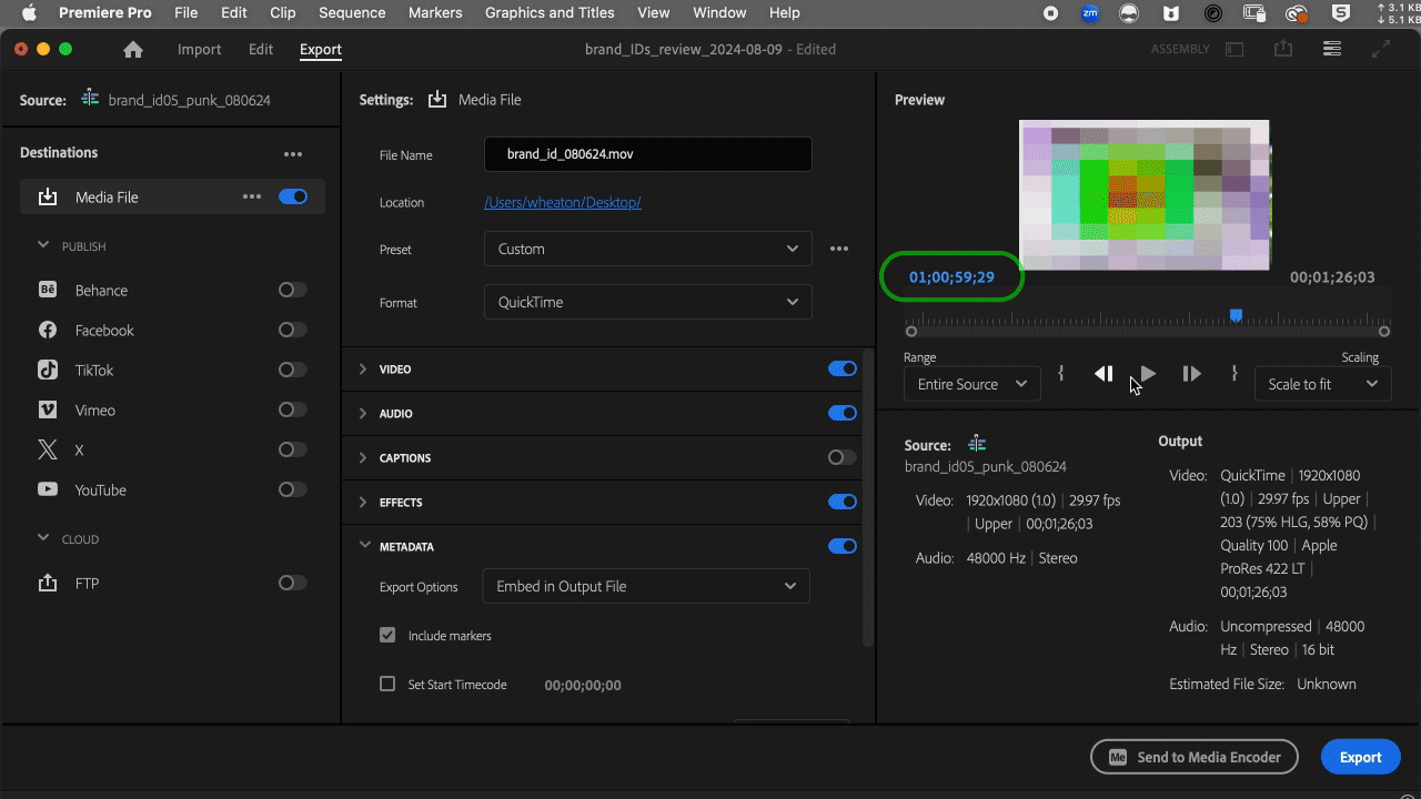

Which version of Premiere Pro is this happening in?  I could try to reproduce it if you want to send just the project file in a direct message.
While in Export mode, what do you see in the Preview panel if you spot check for Drop Frame Timecode?

Hi @dbeaty2 - I can only repro this part of the time.  When selecting drop frame in the sequence settings, it sometimes doesn't switch over.  Can you try creating a new sequence set as drop frame and copy your edit into that, then export as you normally would. Let us know if that helps.
