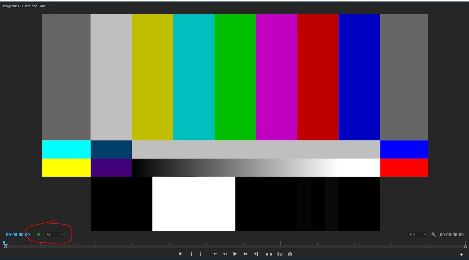

June 24, 2017
What size is your program monitor set to?
June 26, 2017
I tried all of those drop down settings and the footage is still zoomed in. I'm just not sure why it was fine, then zoomed in after the crash. Thanks though!
