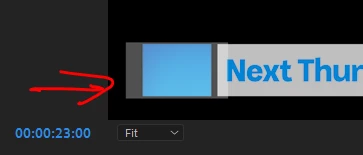

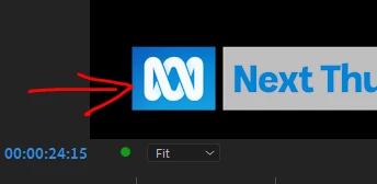

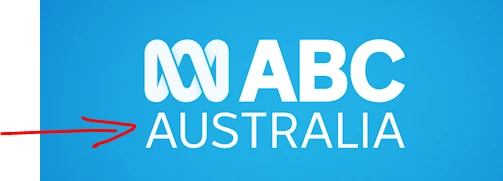

Secondly, and this is unclear as to wether PP or AE are the issue. We seem to have an interpretation issue with some .mogrt files, which we use exstensively. As yuo will see in the attached images, it appears certain blend modes or layer media appear to be misinterpreted or lost. The thumbnail image of each .mogrt, in the cloud library, appear correctly but once imported to PP do not appear correctly.
