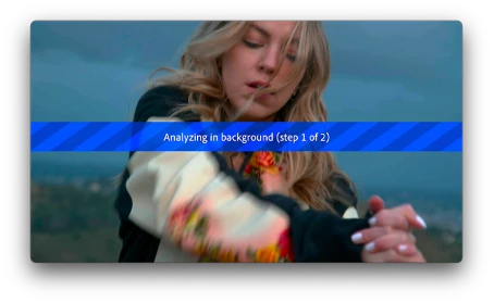

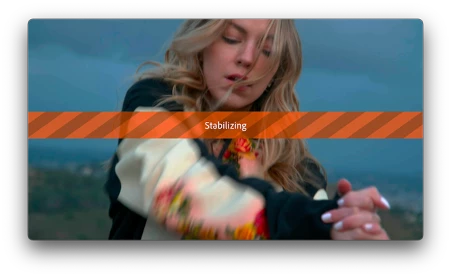

Stabilization is a two-phase operation
  1. Analysis
  2. Stabilization
We found that the analysis phase is taking 90-95% of the overall stabilization process.  We took various steps to dramatically improve the time it takes to analyze the shaky footage while leaving the actual stabilization process unchanged.  The result is that the quality of the stabilization is as good as before – just way faster.

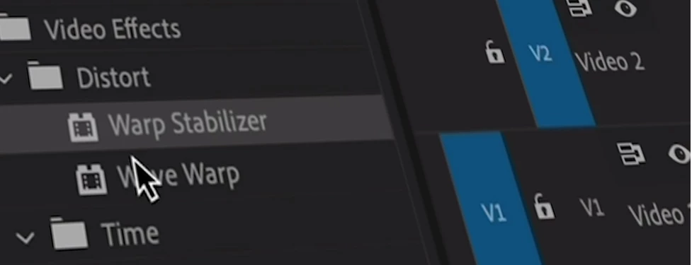

The improvements are turned on by default so just use the tool like you always do.  If you are happy with the results let us know in the comments below.  If you are NOT happy, definitely let us know in the comments.  You can disable these improvements to go back to the old method to compare the results.
Uncheck the Fast Analysis box to revert back to the old version of the warp stabilizer.
