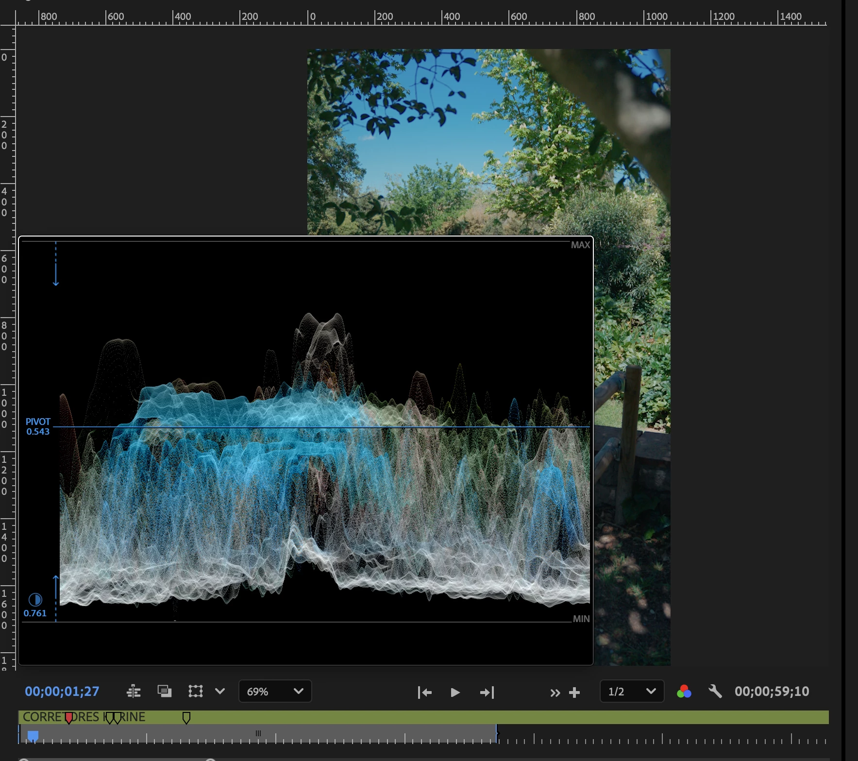

How to change scopes size or location at Color Mode?
Is there a way to change the scopes location or reduce it size? Because I can't see my footage 🤡

    Yes, there are a few ways to do this:
    • While latched (that is, you’ve clicked on the control and the HUD is displayed), you can temporarily hide the HUD by holding down the H key.
    • Change the HUD options:
      1. Click on the wrench icon on the right side of the Color Controls window.
      2. Click on Color Heads-up Display (HUD) options.
      3. In there, you can change the Positioning, Size, and Placement of the HUD.
    Fergus
