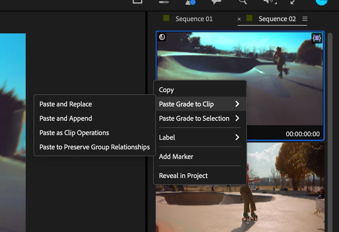

Is there a way to capture a grade and a look that can be used on a completely different project with the new color mode? (We know them previously as LUTs) is there a LUT equivalent?
Is there a way to capture a grade and a look that can be used on a completely different project/timeline with the new color mode? (We know them previously as LUTs) is there a LUT equivalent? My issue is we will shoot various pieces of content with the same setup and lighting and edit them separately. How can I copy that grade onto a new timeline/project or clips on a new timeline or clip outside of the one is was created on?

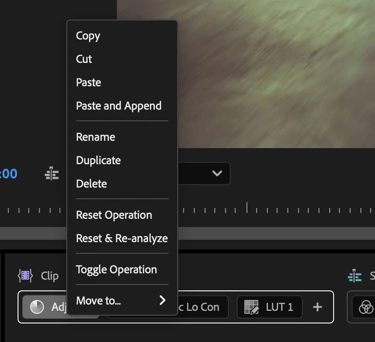

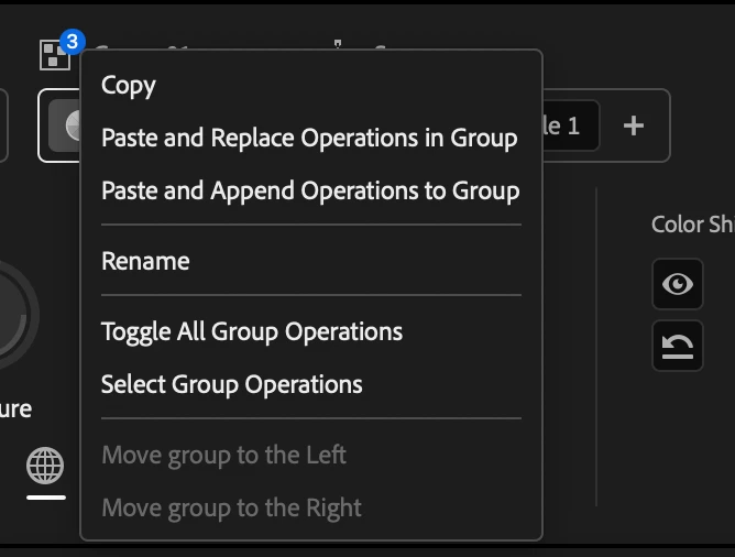

    Please try the various Copy Paste context menu options available at Operation level, Bucket Level and in clipgrid context menu Clipgrid.
    You can copy a clip from clipgrid and it copy all color grading applied(Adjustments/Styles/LUTs) on clip and it can be pasted on other clip in same Sequence or across Sequence/across Project
