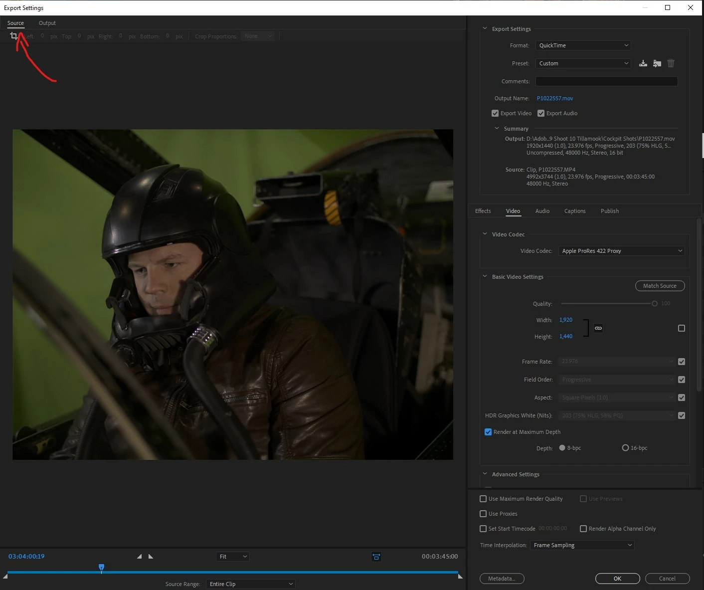

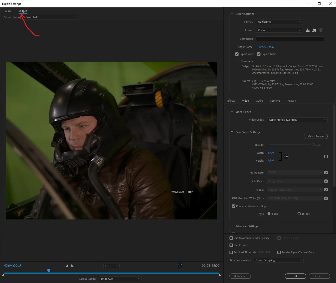

  • Even Media Encoder now has a color/exposure shift when converting HLG media to a Rec. 709 format.  In the past the color would be the exact same between the Rec.2020 original and the Rec.709 Proxy file.  You could do basic color grades on proxy footage and then make any final edits on the actual media, and nothing would change between the two outside the expected loss of detail in the proxy.
    • Again, you cannot get correct Rec.709 proxies from your HLG footage.  Premiere is trying to be too smart, and just assume that you want to convert footage on their terms.  See the attached images for the differences in Media Encoder, mostly in saturation.
