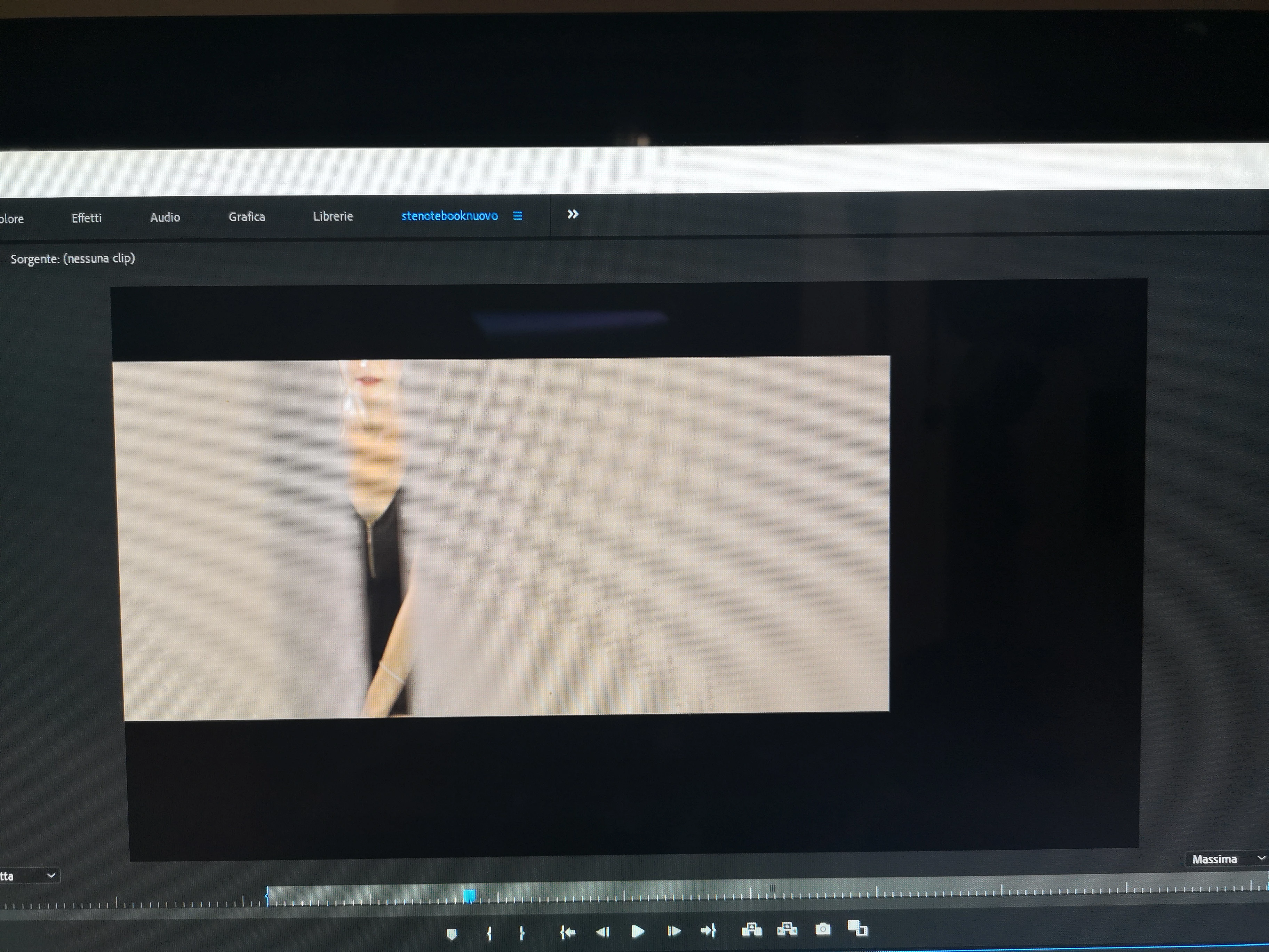

Quando applico una effetto "stabilizzazione alterazione" ad una clip in origine 4k ma applicata ad una sequenza 1920x1080 25p, in play non si vede il fotogramma per intero ma occupa 1/4 sel quadro, Nella clip finale esportata non c'è invece questo problema. Questo bug è presente da diverso tempo anche nelle versioni ufficiali di premiere

Hi baccione,
Can you share a screenshot depicting the issue that you are seeing along with the settings used for Warp Stabilizer effect. Also how did you fit the 4K footage in 1080p sequence - did you use "Scale to Frame Size" or the "Set to Frame Size" option?

it is not easy to screenshot the frame because this happens only in play, while if I am in stop the image is full screen .. I managed it anyway. I put on "set to frame size"

Thanks for the update! I tried similar workflow on my end, and I am not seeing this issue.
To help reproduce the issue, can you please share all the settings that you are using for Stabilizer effect in effects control panel. And can you check if this issue happens with this clip only or with other clips as well? Also what if you try it out in a new/different project, do you see same issue each time?
