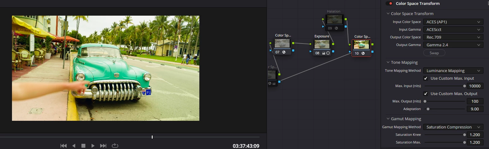

I want to work in a wide color space in Premiere, and I have a lot of experience doing exactly this in DaVinci Resolve. In Resolve, the ACES Transform / Color Space Transform node converts all my media to a wide working space, and the output transform tone maps beautifully. Critically, Resolve's tone mapping lets me push an image and fill the scopes as much as possible without breaking.

    ​Hey ​@R Neil Haugen, could you take a look at this thread? Like I mentioned before, I've been comparing Resolve's color capabilities against Premiere's. I try to push the image as much as possible, but it always ends up breaking. Then I compare to Resolve and get a much richer image. I'm not sure if it's the transforms mapping the data or tone mappers limitation. Open some of the comments too — there's a car example in Resolve worth seeing.

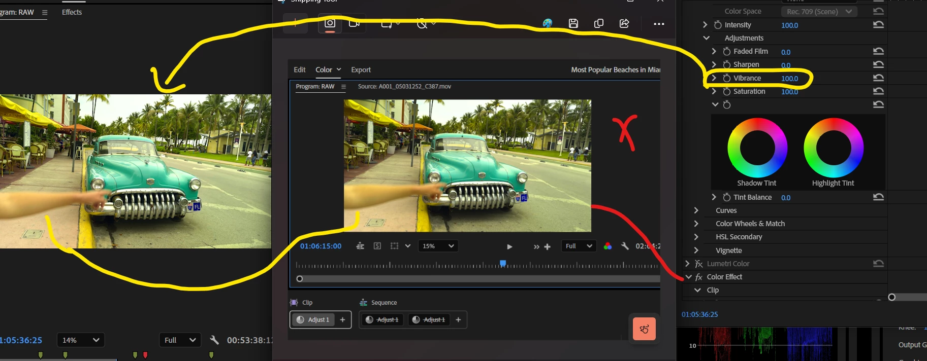

    Jul 2, 2026 3:03 AM UTC
    On this right image i added saturation though the color page and on the left image i added vibrace though lumetri BEFORE the color page.. i get a much balanced shot this way and avoid the awful yellow skin tone look. a lot closer to davinci.
    On the right image, I added saturation through the color page. On the left, I added vibrance through Lumetri before the color page. The left shot is far more balanced and avoids that awful yellow skin-tone look much closer to Resolve.
    The takeaway: the color page needs a vibrance option, either replacing the saturation knob or sitting right next to it. Vibrance protects skin tones by boosting the less saturated colors more than the already saturated ones, whereas the current saturation control pushes everything equally and blows out skin. Having to route vibrance through Lumetri beforehand just to get a clean result is a workaround it should be native to the color page.

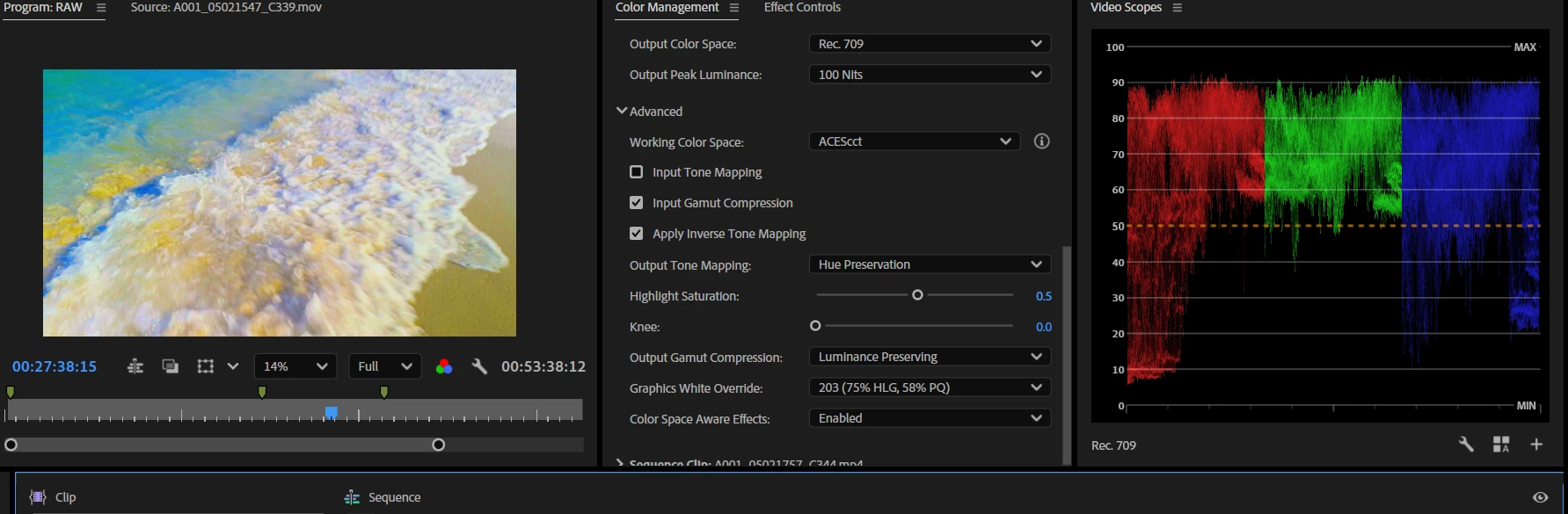

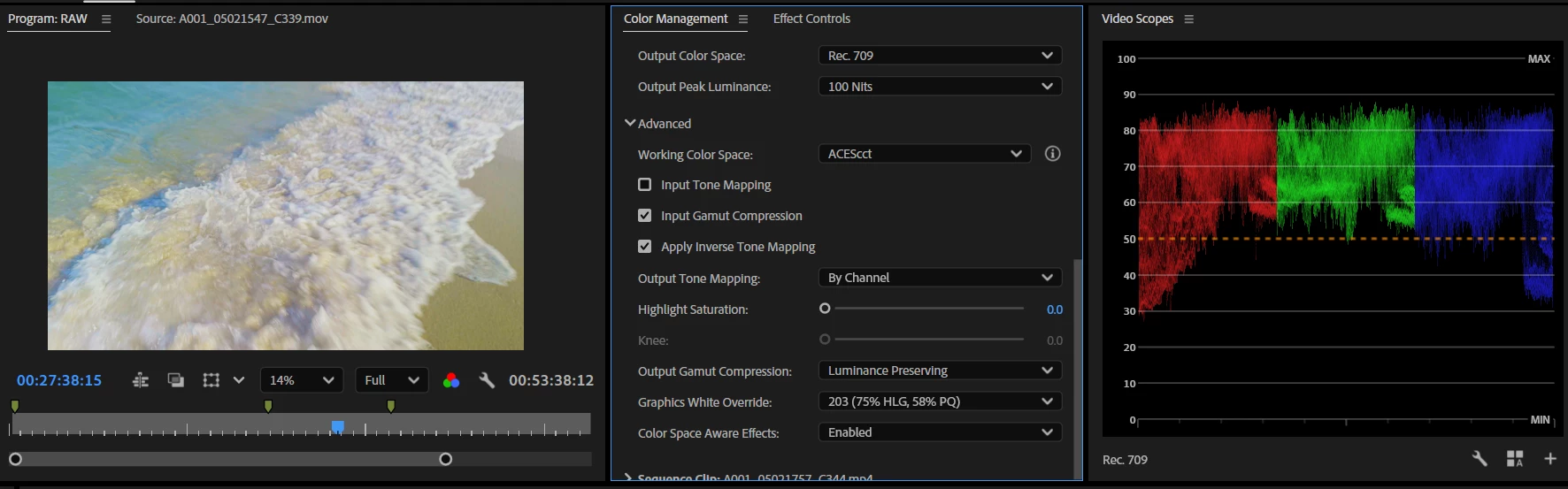

    Jul 2, 2026 12:01 AM UTC

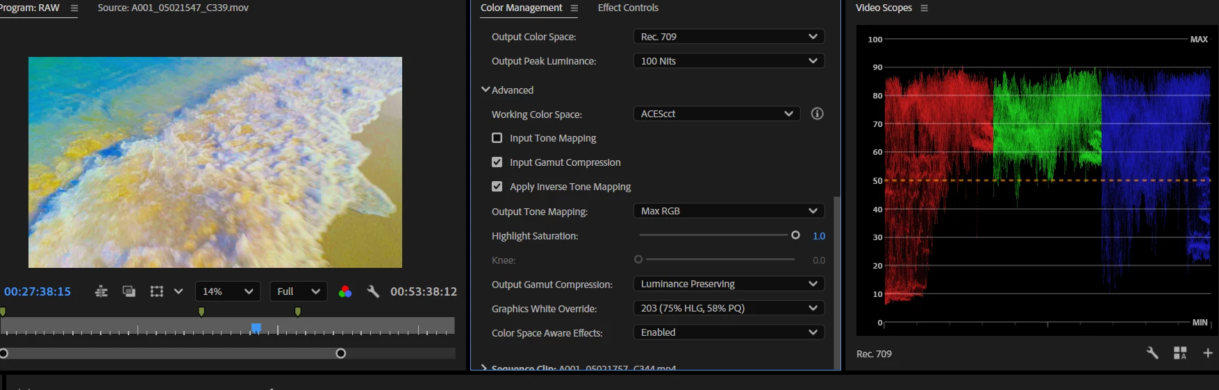

    Testing the other tone mapping methods.
    Max rgb:
    Hue preservation:
    By channel:
    Adjusting the highlight saturation and knee where possible doesn't help either.. too much detail is lost.

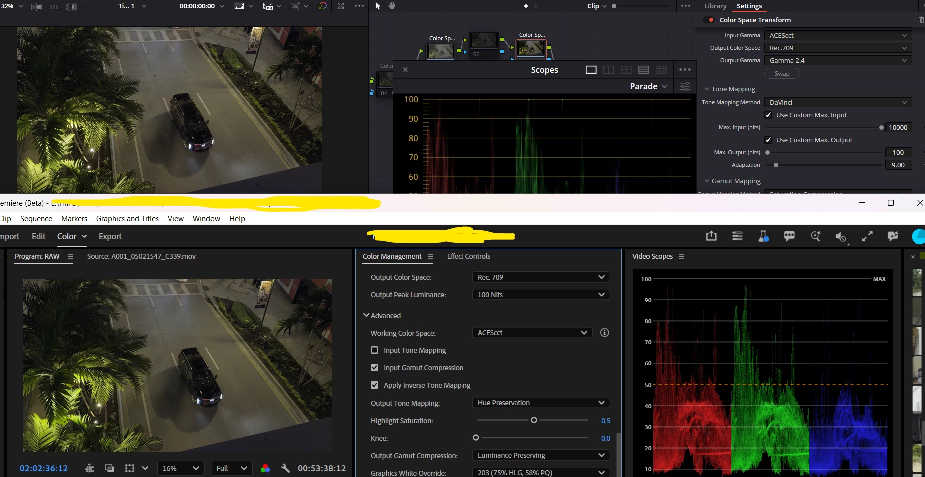

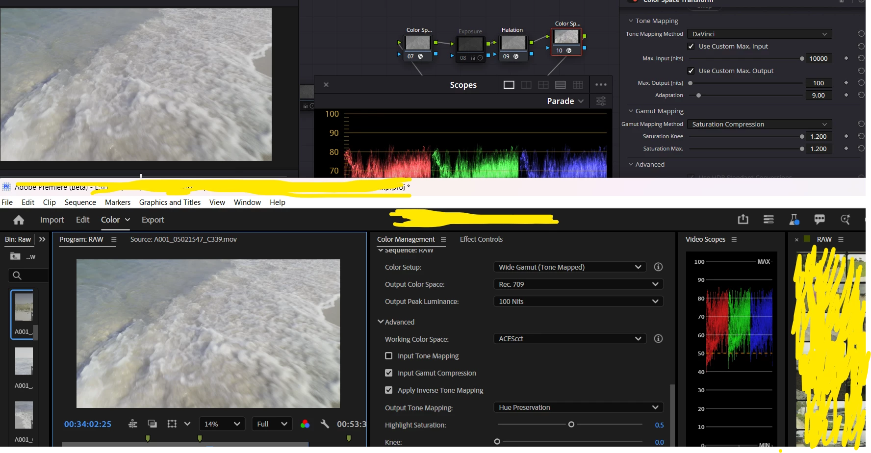

    PabloQSAuthor
    Jul 1, 2026 11:55 PM UTC
    No grade — just the input transform. I tried both Apple Log and Apple Log Wide Gamut, same issue either way. Resolve looks noticeably richer. You can see the scopes barely reach 100 in Resolve, while Premiere doesn't get there at all.

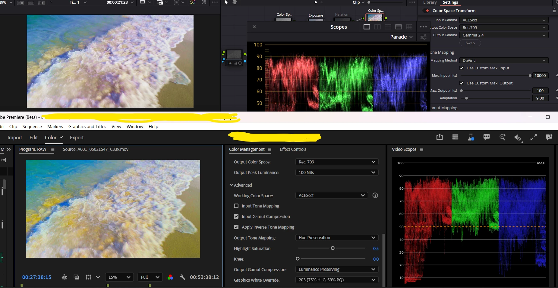

    Here's another clip with only the input transform applied though the rec 709, no grade yet. It holds up somewhat, but there's that yellow cast in premiere.
    now with the grade:
    The Resolve version preserves far more detail when I try to hit that same look. The more I push exposure in Premiere, the more the image loses punch, and the colors flatten out.. less gradient, less subtlety in the transitions.
    In Resolve, the colors hold their gradient and the image keeps its punch as I push it up. Resolve simply doesn't fall apart this way when I need to lift the image.
    As I mentioned before, every tone mapping option in Premiere seems to produce this same washed-out result. This isn't a one off with a single clip it's consistent across footage.

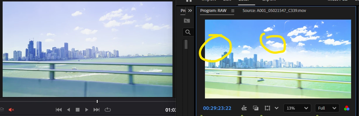

    Jul 1, 2026 9:32 PM UTC
    Here’s a side by side comparison of the artifacts that i get with all the tone mapping options in premiere vs davinci.
