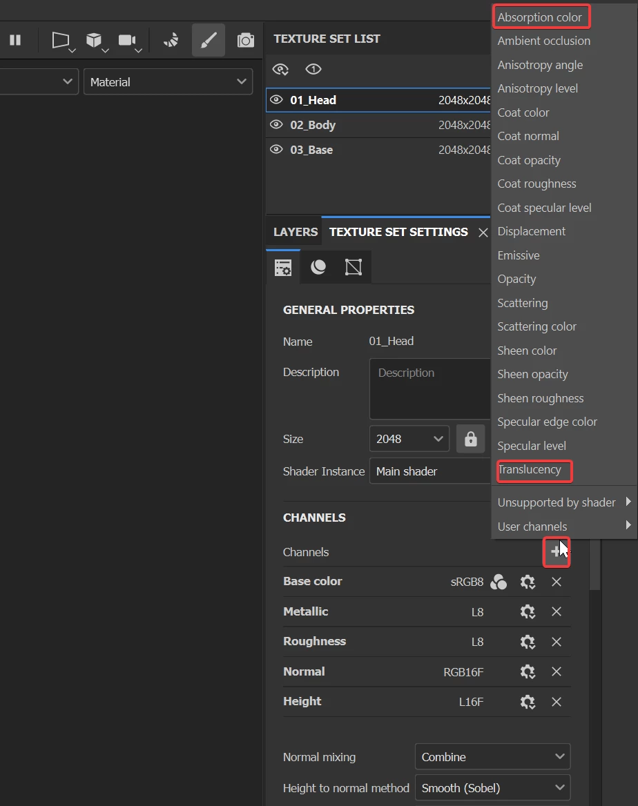

Hello @bfuzz,
If you're sending your work from Painter, I advise you to export it with the same material parameters. Don't worry, the differences you see between Painter and Stager are simply due to different engines. Once the work is exported, it should look the same.
To add the Transluency and Absorption, go to Texture set settings > Channels and add Transluency and Absorption.
If you want to display the Channels properly in your 3D viewport, go to your Shader settings, and enable Transluency and Absorption.
You can now set in a layer the same value you had in Stager (Transluency: 0.99, Absorption: bluish).
Send it to Stager, and you'll see the result will be similar as what you previously had.

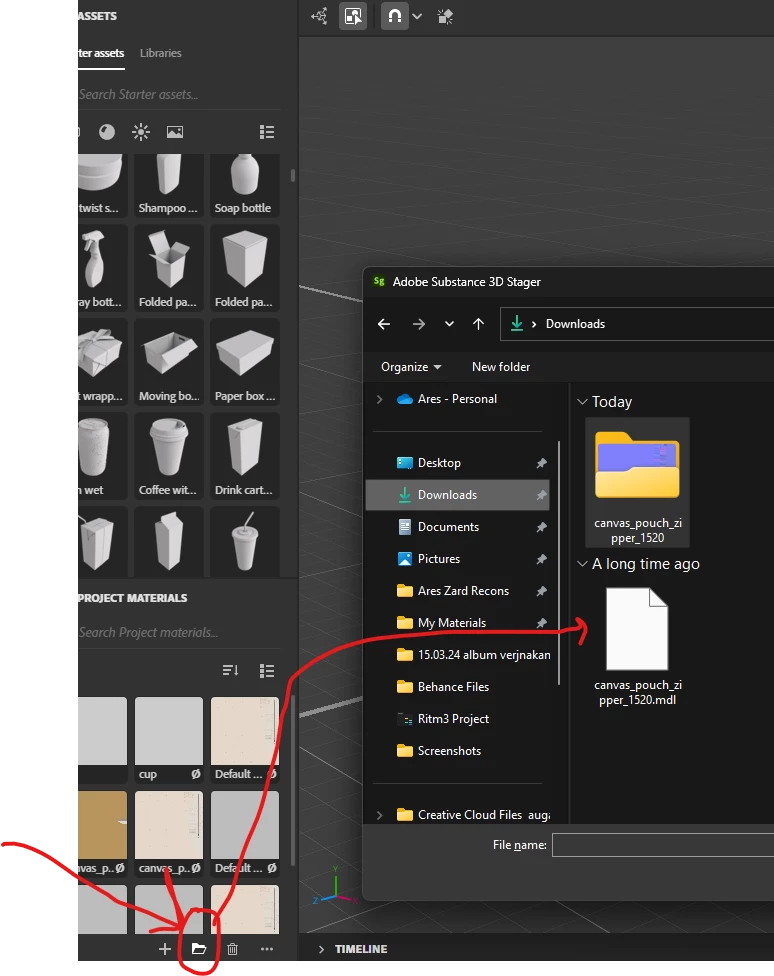

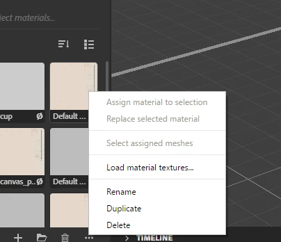

Ares Hovhannesyan
Mar 26, 2024 4:51 PM UTC
Not sure but maybe this can help you: Importing MDl into Stager, After importing you will be able to find it materials panels.
