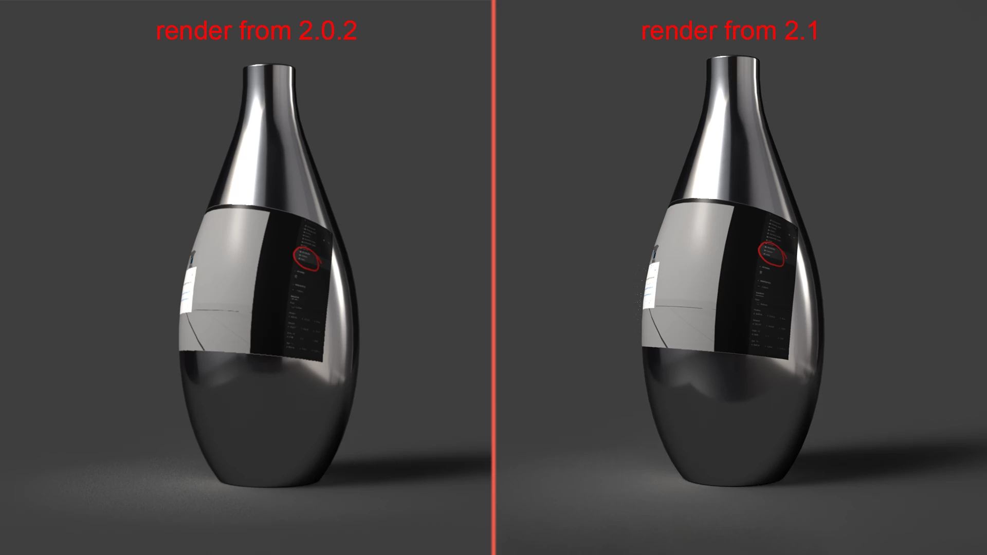

Is anyone else noticing wildly different results amongst renders done before today's update (2.1) and any previous version? I'm opening a file I rendered just yesterday (2.0.2) with today's update (2.1,) and the results are completely different when I render it again with 2.1... same file, and the render is completely different with the 2.1 update.
Why should I have to research and adjust my historical file's long-standing Material properties so that 2.1 renders will look like every version rendered beforehand? I am supposed to edit every single past file, just to hope to get the same visual results with which I have been pleased in the past? Ridiculous.
This update is complete $#!@ when it comes to consistency of file rendering existing files with the same results past versions created. Just look at this attached example, which uses the same exact file to render... why on earth would 2.1 introduce rendering that won't render a consistent look with any version which rendered it before?
We're supposed to spend our time adjusting past files in 2.1, in the hopes they might render as they always have? 2.1 will cause me to lose more time by having to tweak past files. And... the exported GLBs look completely different as well. Really? Really?! 🤬

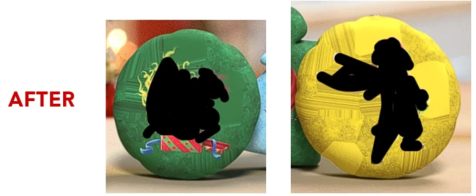

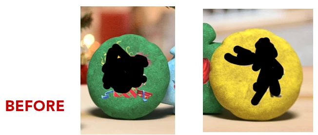

I have the same issue! I created this file a couple weeks ago, here's a before (opened/rendered with Stager 2.0.2), and after (done with Stager 2.1)...
Other than the very obvious issues with decals on materials, also colours, lights and shadows now render differently, on all files I'm opening.
I'm downgrading back to Stager 2.0.2 for the time being, but please @Cyril Dellenbach be aware this is an issue that needs to be fixed. People need to be able to keep consistency within their saved files.

I did some renderings in Adobe Stager a few weeks ago; the rendered items had a felt fabric type material applied to them, and an image decal on top of the fabric. (Image is blurred due to licensing copyright)
Both the material and the decal had satisfying quality.
I re-opened the same files today, to quickly edit and redo some renders, using the latest version of Stager. This is how the same items look like now :
This is not acceptable, I need to be able to keep consistency within the same files. I have tried to fix the texture and decal in every way, but they still show like in the 2nd picture, as soon as I apply the decal image.
The file had no issues whatsoever last time it was saved and closed, I need to be able to open files and find them exactly how I left them.
Has anyone experienced the same issue, and/or a way to solve it?

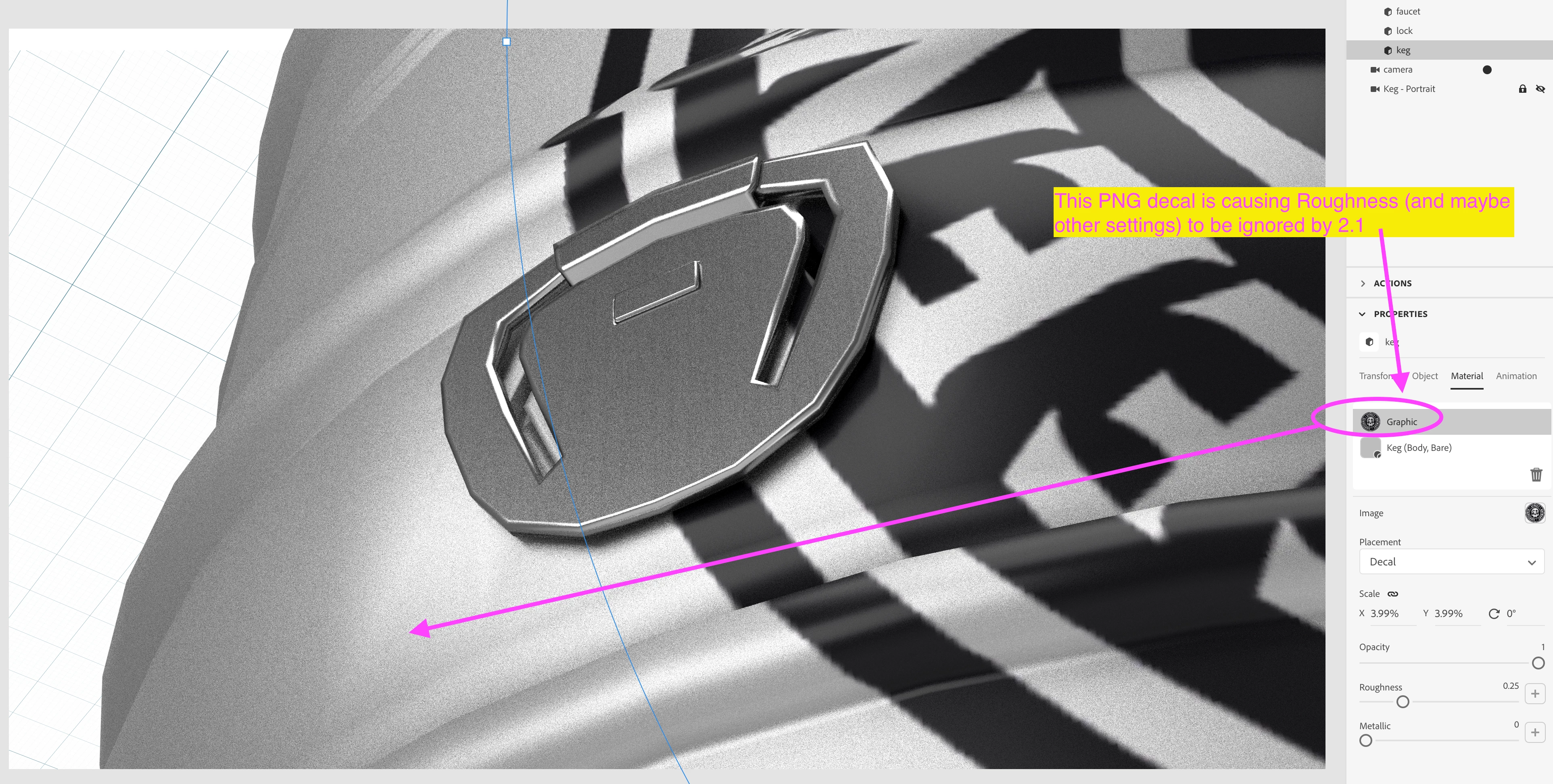

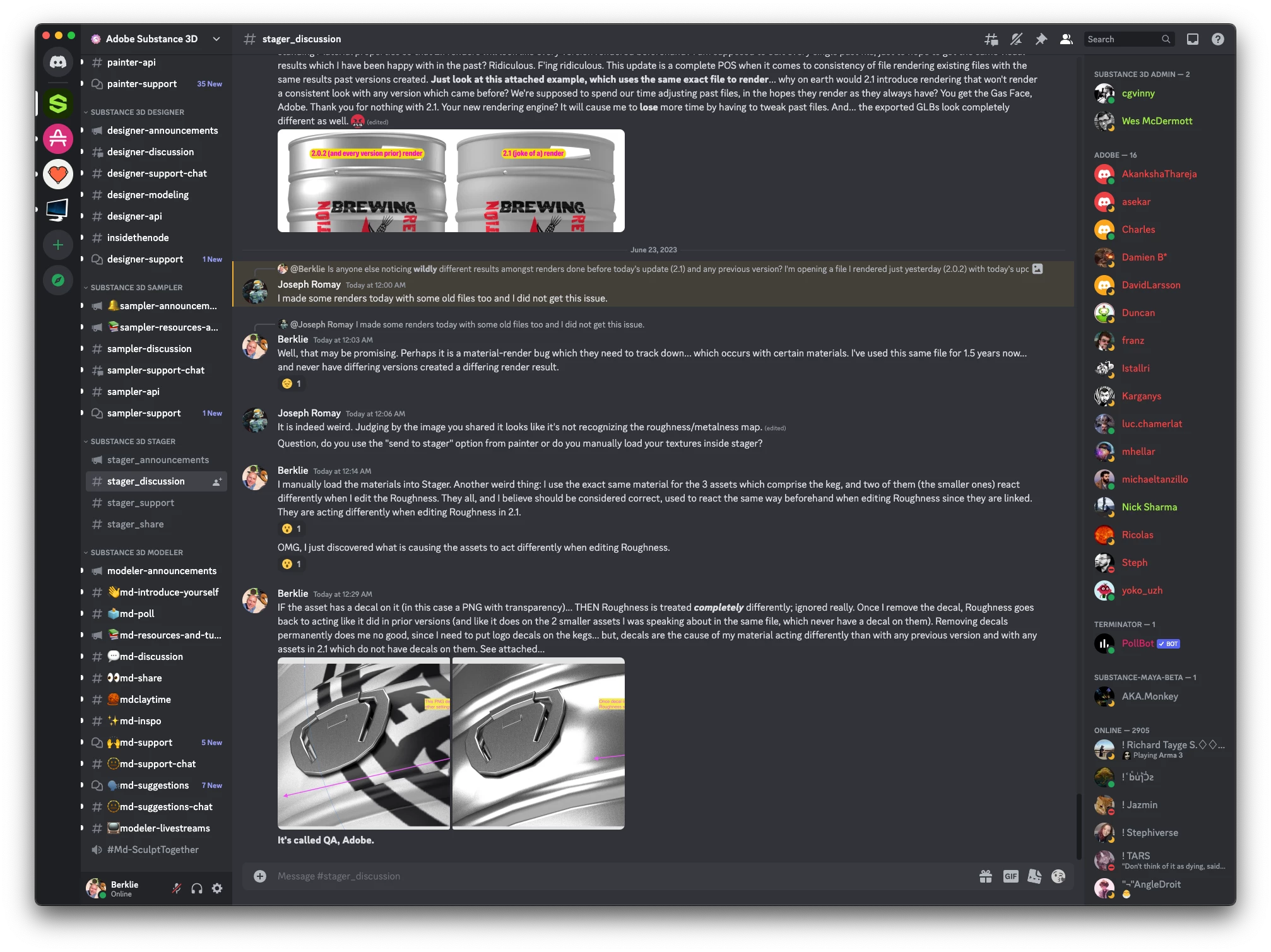

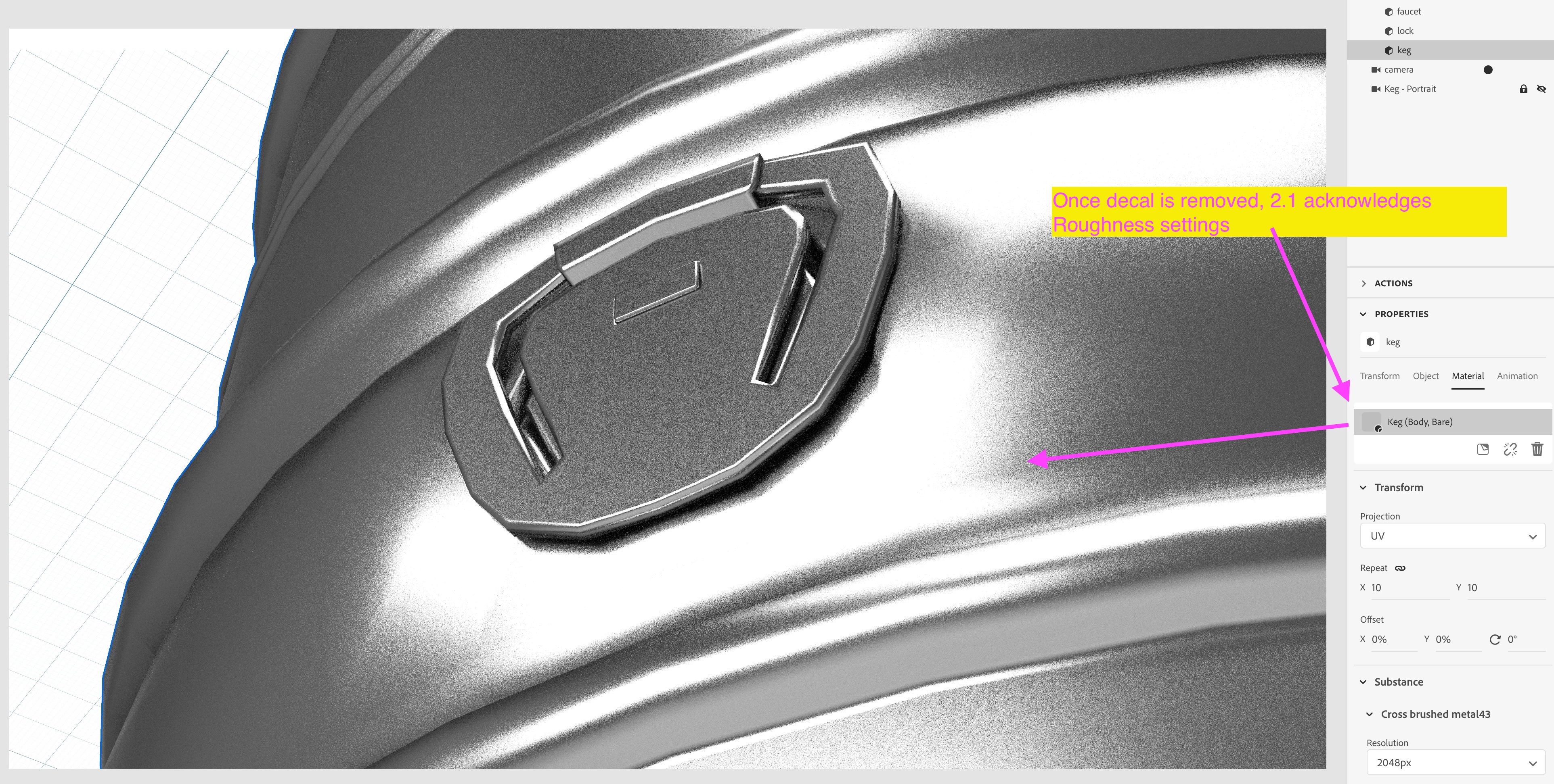

BerklieAuthor
June 23, 2023
And I found the bug which is causing this. I am going to call it "Decals on materials cause Roughness (and possibly other) settings to be ignored."
I'm to tired to write up everything, so here attached a screenshot of my Discord discourse about this.
Please contact me, @JMathews . Thank you.
