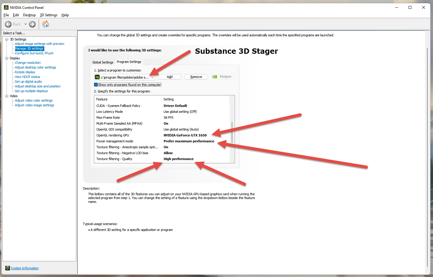

BiancaBZN
Solved this in the FORUM ...
New Here , Jul 28, 2021  ))))
All this BLAAA BLLAAA  BLAAAAAAAA,   :::
and you are the only ONE w/ the CORRECT Soulutions...
" Here is the solution, received from Marco and worked for me. Go to Nvidia Control Panel --> Manage 3D Settings --> Program Settings --> ADD  Adobe Substance 3D Stager on select a program to customize --> SELECT > High-Performance Nvidia Processor.  """
I encl. BIGGER Pic. so folks can see in  propper view below ...
ADOBE SUPPORT ONLY ASK FOR THE: LOG FILE  and NO Conclussion to solve this - Better you work ON ADOBE and get the 10.000 USD / Monthly...
/// McRoman
Save and OPEN pic. BELOW :::  in some Picture Viewer who can ZOOOOM .... so you can see it clearly  ...
PS: My Substance 3D Stager 2024-05-24 ::  RENDER in FULL SPEED now w/ the GPU 1650 --- NO ERROR any MORE ...
THX to BiancaBZE  ...

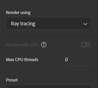

October 13, 2023
I believe I may have found a "solution" to the issue of the "Render with GPU" option being greyed out on my XPS-15 9350 with GeForce RTX 4060 Laptop card. "Render with GPU" was available after it was available upon first setup but disappeared after an update. I fully wiped the machine several times, updated and rolled back drivers and did all the solutions presented in the forms or in the Substance support documentation.
The solution that has been working consistently for me is to - **In the Design panel** turn Ray-Trace on. Select the Settings drop-down just to the right and turn on "Render with GPU". This seems to be working consistently for me to enable GPU rendering.

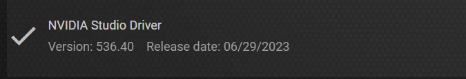

AlanGilbertson
July 16, 2023
将您的系统更新到最新的 Nvidia Studio 驱动程序,即 536.40。如有必要,请完全卸载驱动程序,重新启动系统,然后全新安装新驱动程序。

I can not use GPU Rendering although I updated everything including BIOS. Why on earth we can't use GPU rendering while using stager with a high quality laptop just bought for this! No recommended solution resolve the issue.
AMD Ryzen 9 6900HS with Radeon Graphics 3.30 GHz
July 1, 2023
Issue solved after 12. reset:)
June 29, 2023
Hi JMathews,
I'm having a similar problem even now in 2023. I have a new installed RTX 3090 with fully updated drivers (536.40-Studio), and I'm running Stager 2.1.0. Need to render out some scenes today and can't for some reason..
HALP
Thanks, Dan
AlanGilbertson
June 30, 2023
Hi Dan,
Need a bit more info. As it happens, my desktop system also has an RTX 3090, running the same studio driver version, and Stager 2.1 is not having any problem with renders (in fact, since the last update, they go at a ridiculous speed). What's your Windows version, CPU, available RAM? And have you reset you Stager preferences?
