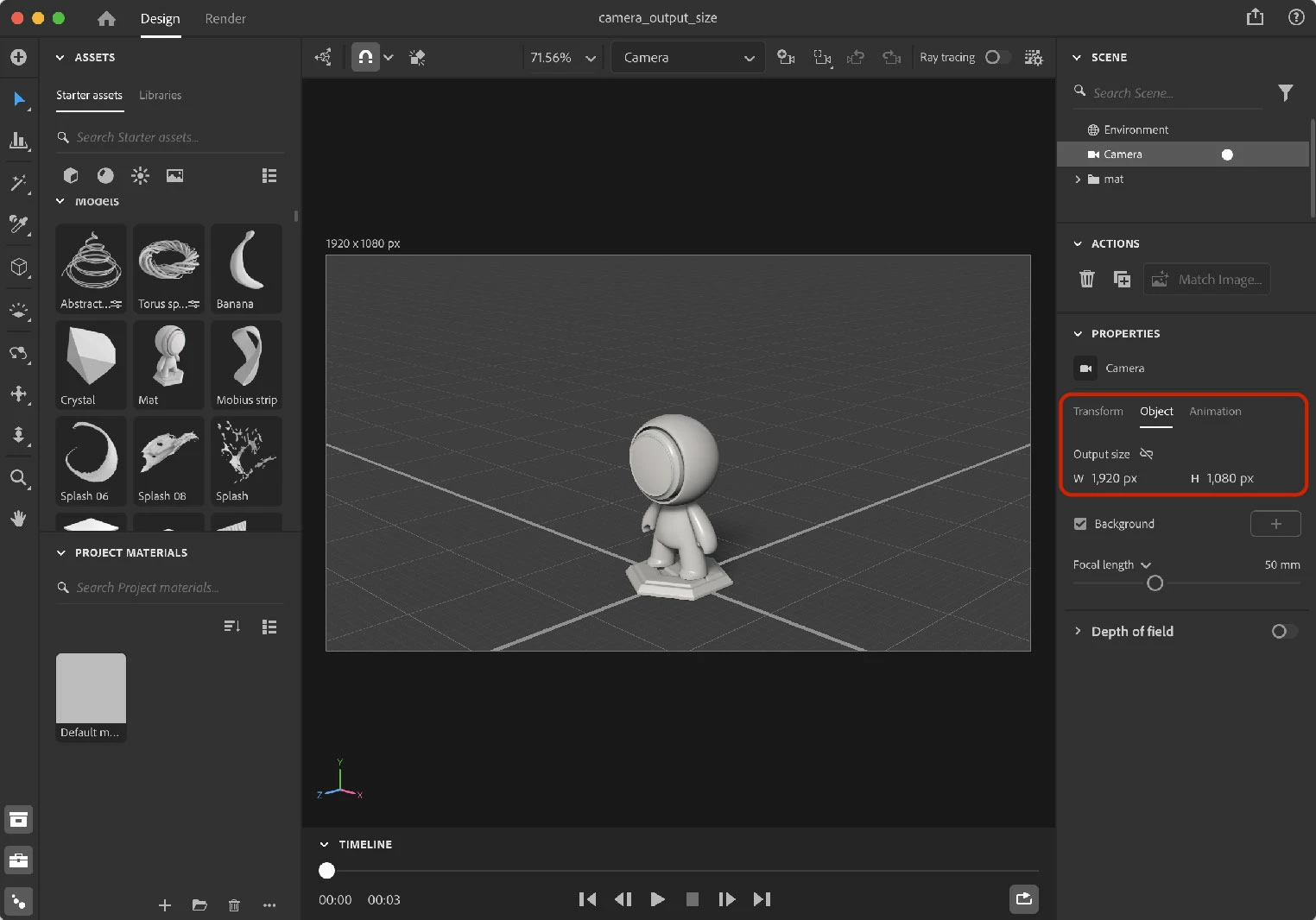

The first way is changing the output size of the camera.
  • Select the camera
  • Go to the object properties tab
  • Type in new camera size

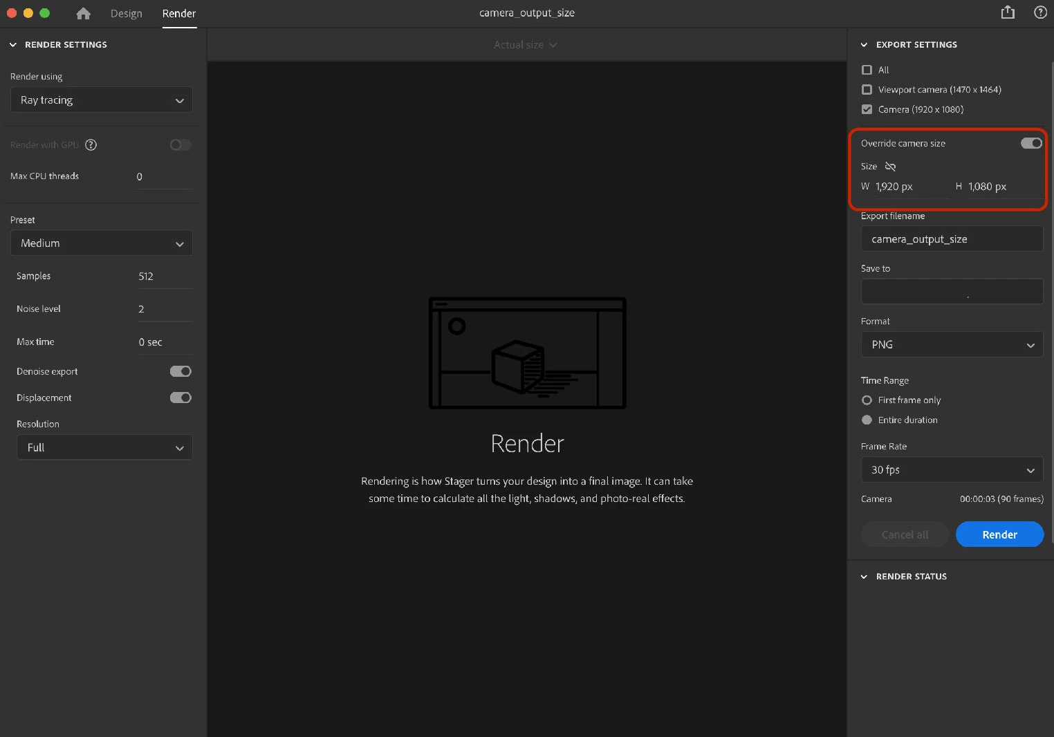

The second way is using the override camera size while in render mode.
  • Go to export settings panel
  • Select the camera you want to render with
  • Toggle on override camera size
