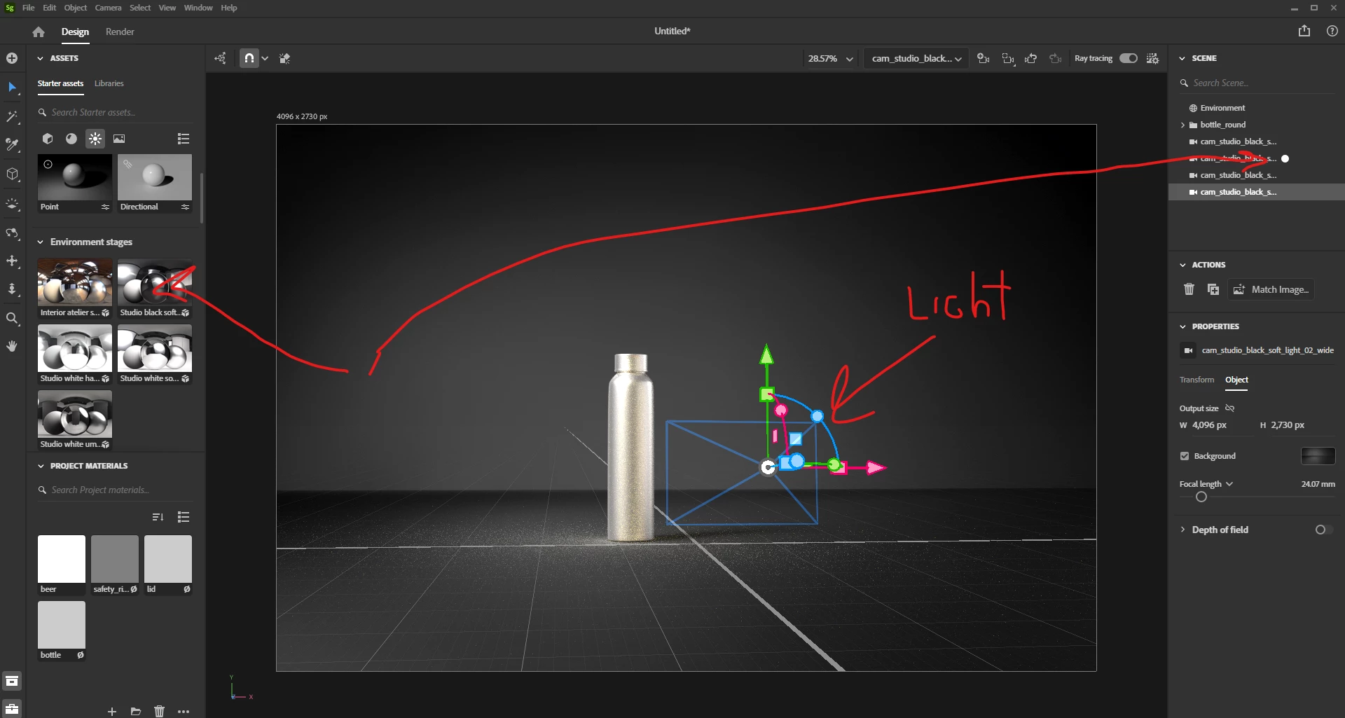

What I can suggest is to use studio light (cameras) from lights assets and choose correct material for your object .Also please review material guide to understand how their properties works. Adobe Standard Material | Substance 3D Sampler
Try to use Interior that allow to manage translucency
After exporting studio light you need to turn it separate camera and unlock for managing that scene.

Hi Ares, Thanks for your professional advice! I've tried "Interior" and it works just fine. Thanks a lot!
