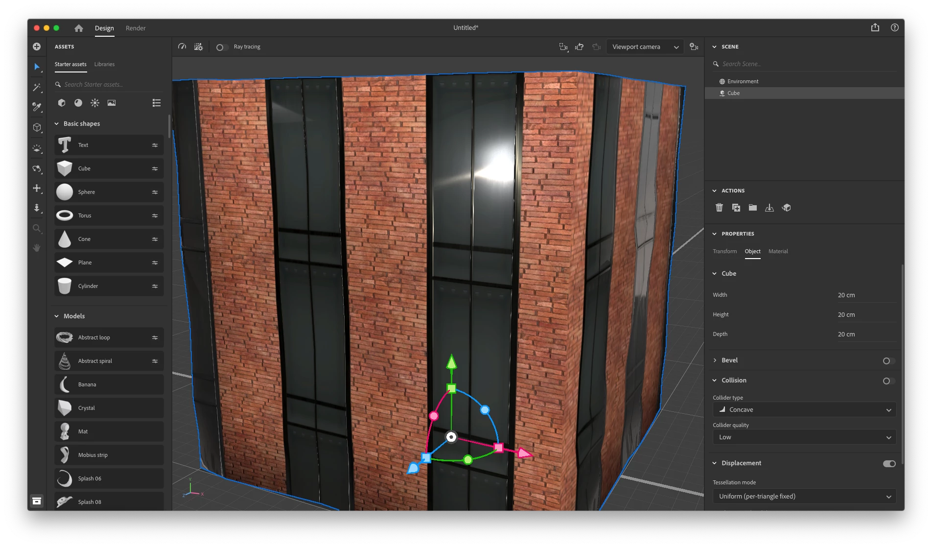

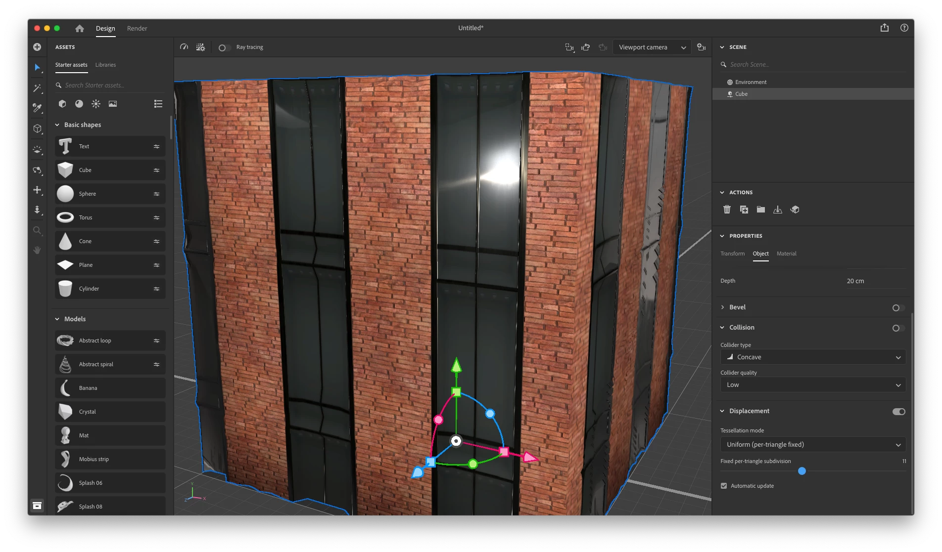

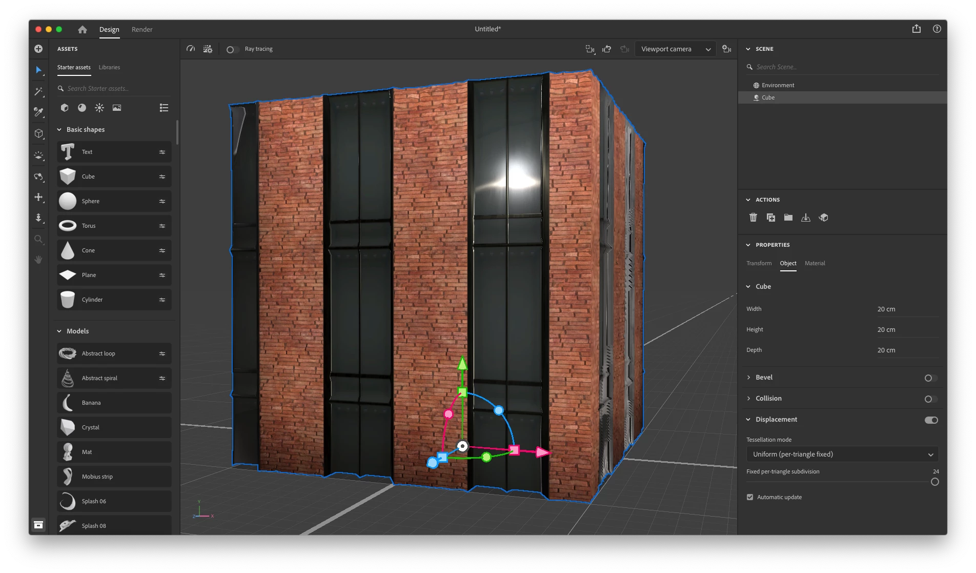

3. When I want to use the Displacement I see random displacement that does not fit to the material. I can work on the normal and height sliders. When displacement is turned on, it all turns out pretty strange and has nothing to do with the sbsar file it seems.
4. When I use bevel on the box I make in Stager and want to use the Displacement on one of these sbsar files I found on your page, it comes with a warning about that Displacement does not work.

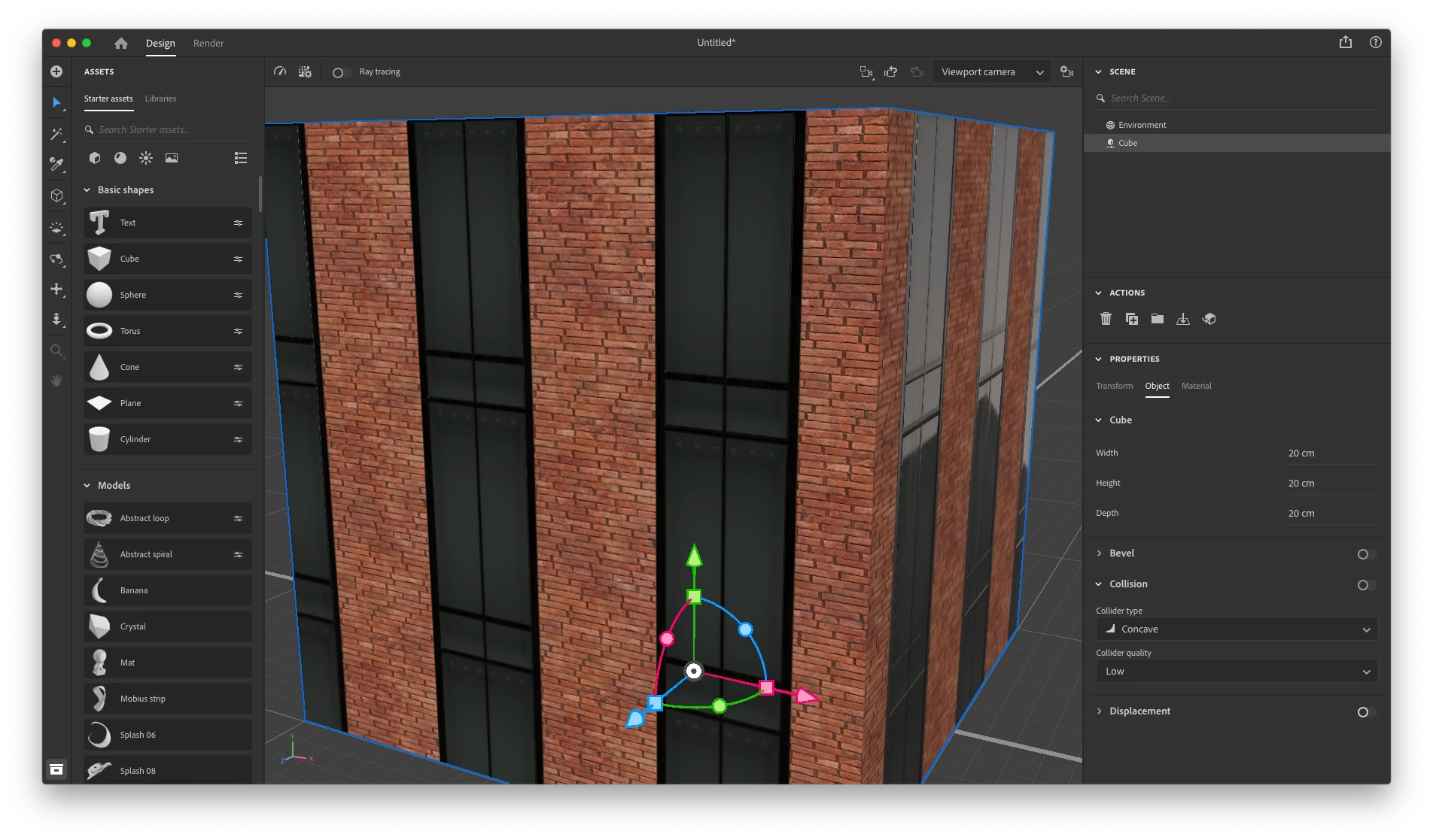

No sadly not. But as I see it, I guess it is not the material that has an issue but the basic cube mesh in 3D stager that has only few polygons. Because the material works on the plane mesh. I just don't know how to make the cube with higher quality (polgon wise)?

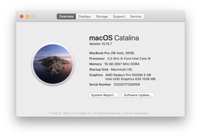

Hi could you post a screenshot of the unexpected displacement result? Also could you give us some details about the hardware you are running on? Thanks.

As for the displacement, what you see is the result of your model not having enough polygons to have precise displacement. This type of material, with very sharp edges, requires a lot of polygons to work well.
I'd recommend switching the Tesselation mode to "Uniform (total face budget)" and increasing the value to a high number, like 100,000 or more
