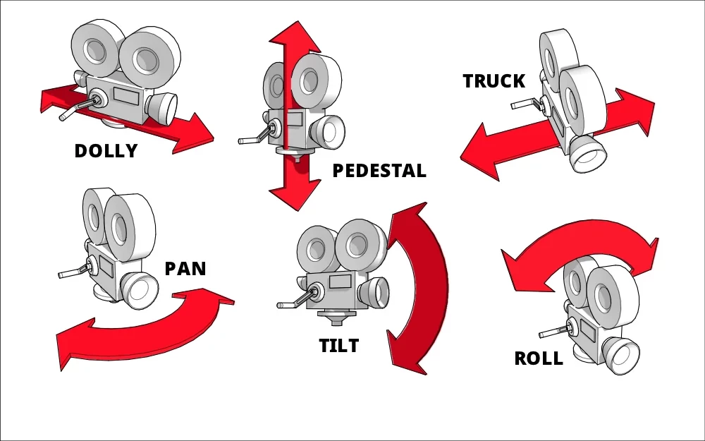

I put in nice, clean numbers and make one small move and then everything is negative this and negative that. And then I try to correct it and the camera rotates sideways and upside down when I put the original numbers back in. Somehow up/down left/right becomes some weird relationship of rotating around the center point of the camera making everything slightly off from straight. I don’t get it! Selecting a camera should give you actual camera motions: Pan/Tilt/Dolly/Roll/etc
Us poor graphic designers NEED this tool (for me the Dimension variant), but it keeps getting neglected by Adobe. I need to make real life objects with actual physical dimensions in real life settings, not just artsy-fartsy video game decorations and it’s rough when they break the coordinates systems and you just have to noodle around.
