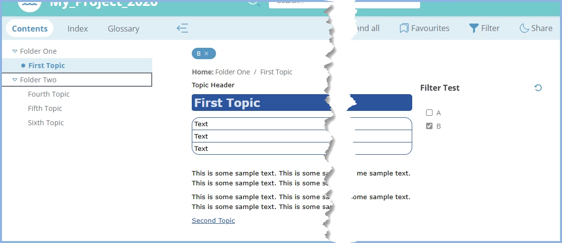

    Using the TOC to apply tags, I applied Tag A to the Folder One section and Tag B to the Folder Two Section.
    That works perfectly when I select filters A and/or B.
    Then I added Tag B to a topic in Folder One. When I select B in the filters, that topic now shows. That is correct because the user has chosen to see anything with B applied.
    To exclude anything with both A and B applied, you need to write a Condition Expression and drag that into the filter options.
    Re applying tags to Content Folders, I will take that up with Adobe as I thought that was an option. Perhaps it has been removed.
    Does this clarify things for both of you? ​@Karin Albrecht 2 ​@Rosee321
    My site www.grainge.org includes many free Authoring and RoboHelp resources that may be of help.
