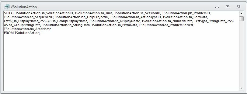

I think we got it fixed. Here's the deal.
For some reason, the Database set up all the tables but no views initially. My DBA created the views manually using the definitions from the included access database. In Access, if you go into queries, then right click on the table, select "design view".  Right click on the design view, select 'SQL view' and you can view the SQL statements used to define the view.  You should be seeing something like this:
She slightly modified them--here's what she created:
Created the views for  MCVICKER in ROBOTST.
create or replace view mcvicker.VSolutionAction
SELECT
TSolutionAction.sa_SolutionActionID,
TSolutionAction.sa_Time,
TSolutionAction.se_SessionID,
TSolutionAction.pb_ProblemID,
TSolutionAction.sq_SequenceID,
TSolutionAction.hp_HelpProjectID,
TSolutionAction.at_ActionTypeID,
TSolutionAction.sa_SortData,
Ltrim(sa_DisplayName,255) AS sa_GroupDisplayName,
--Left$([sa_DisplayName],255) AS sa_GroupDisplayName,
TSolutionAction.sa_DisplayName,
TSolutionAction.sa_NumericData,
Ltrim(sa_StringData,255) AS sa_GroupStringData,
--Left$([sa_StringData],255) AS sa_GroupStringData,
TSolutionAction.sa_StringData,
TSolutionAction.sa_ExtraData,
TSolutionAction.sa_ProblemSolved,
TSolutionAction.ha_AreaName
FROM TSolutionAction;

Update-- the SQL statement that the database is returning the error on seems to be
SELECT COUNT(sa_SolutionActionID) AS countDATA FROM VSolutionAction WHERE at_ActionTypeID=30 AND pb_ProblemID = 397;
VSolutionAction is the table that doesn't exist.
I'm not seeing a VSolutionAction table in the sample database, either.

OK, more information on this topic:
I believe that VSolutionAction is a table that doesn't exist because it's actually a view. The sample database is built in Microsoft Access and calls this a 'query' instead of a view.
My guess right now is that the database user that we used to set up the ODBC connection and the configuration manager had permissions to create tables but not views.
So my question at this point is: how can I trigger Robohelp Server to set up new tables and views on the connected database?
