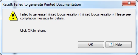

Hi. I'm tire kicking RH11 / FM 12 with the trial copy.
On 3 or 4 separate documents, I can successfully print to .docx format, but I can't print to PDFs. When I try, the program quits with message just below. I've also attached the compbilation log, which ends with "Internal error encountered,  Failed to generate Printed Documentation. "
I can print the resulting .docx doc to PDF from Word. But that's an extra step I'd rather not have to take.
Any tips on what might be causing this PDF crash would be appreciated. I see that other's have had similar problems in the past, but its not clear if their was conclusion on their issues.
Thanks in advance.
Kurt

Generating 'Printed_Documentation.pdf'...
Failed the generate PDF file 'C:\Users\keuler\Documents\My RoboHelp Projects\00001\!SSL!\Printed_Documentation\Printed_Documentation.pdf'...
Failed to save 'Printed_Documentation.doc'...
Cleaning up temporary files...

Peter Grainge
February 10, 2014
Do you have more than one version of Word installed?
Do both show the Acrobat ribbon?
See www.grainge.org for RoboHelp and Authoring tips
@petergrainge
kdeulerAuthor
February 10, 2014
Thanks Peter. I only have one version of Word installed, but your top about Acrobat ribbon is a good one, I'm sure. No, I don't see this in the ribbon, and, per these instructions:
http://forums.adobe.com/message/4781407
I see that the PDF add-in is in the disabled list. I'll follow the instructions there to add it in. (My guess is that this will fix the problem.)
Thx.
