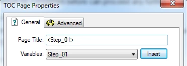

Dec 19, 2016 8:29 PM UTC
If you create a variable for each step:
And then setting the page property to the appropriate step:
you would get the desired result.
To be clear, personally, I do not endorse this method because it relies upon manually numbering the steps. The advantage of using the step as a variable may / may not be a good strategy, but it was my first reaction.
